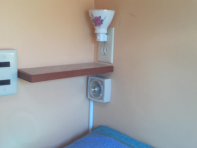

Postby satch » Thu Oct 09, 2008 12:45 pm
Gary J wrote:Rick,
I will agree, the look of the thermostat is a turnoff, but it does what I would like it to do. I am assuming the sensor is the coil part. I wonder if a nice wooden box, leaving the coil exposed, would be an acceptable way to go.
Gary
I don't see why not.
Here's a pic of mine, I like the idea of having by my head so I can contro the settings with out getting up, plus I can shut it off/on with out getting out of the blankets 8)
