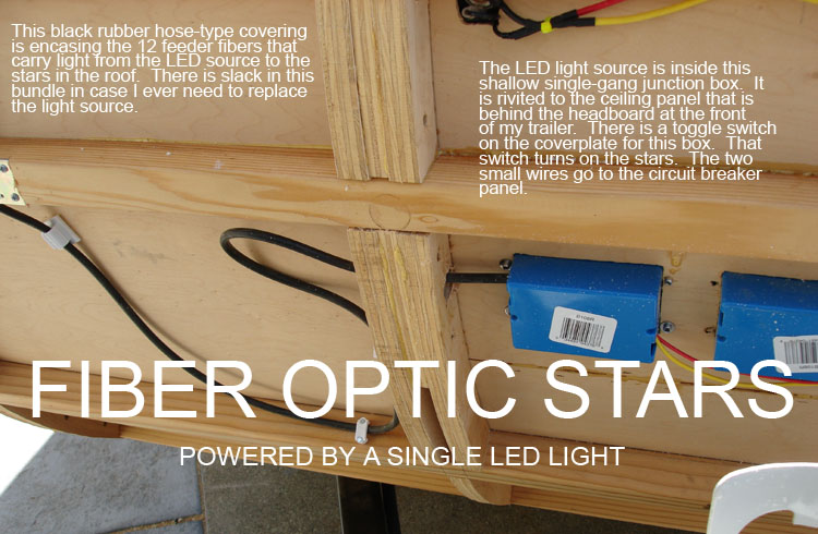

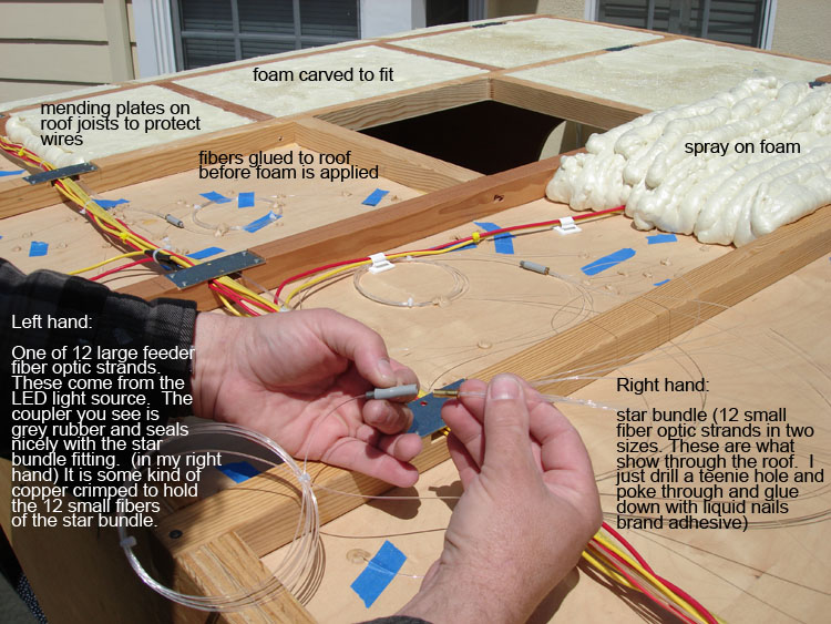

Postby Duane King » Thu May 17, 2007 2:36 pm
Okay, I've got stars. I haven't tried to take a picture at night of the overall effect. I don't know how to get my camera to take a picture in the dark. But trust me on this: FIBER OPTIC STARS ARE REALLY COOL!
I've got 144 stars in my roof and it really does look like you are looking up at a bright night sky. I like it very much. The entire system just draws a few milliamps, so I expect to always be able to sleep under the stars without draining my battery. All of the stars get their power from just ONE LED bulb. Pretty cool, huh? This is actually the worlds most expensive nightlight. :lol:
The manufacturer modified their 9 volt kit to run on my 12 volt rv battery. I had to pay for this additional engineering on their part. The whole thing cost my $275.00. I know that is a bunch, but after seeing the finished effect, I don't think I will build any other trailers unless they also have stars in the roof. I like it that much.
