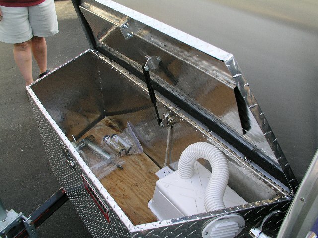

Anyway, the directions for installing this thing say to not let the back of the panel be anywhere near lead acid batteries because they cannot guarantee a spark won't ignite battery fumes. But this is exactly the location I intend for the panel. I want the front of the panel to be down at the feet of my sleeping cabin and the back of the panel to be in the battery compartment under my galley.
I called the place where I ordered the panel and they said, "No problem, just put a vent in the sidewall of your battery compartment so off-gases cannot build up.
What do you folks think? Do I need several vents so I get cross ventilation? The battery storage is about 12" x 18" x 14" and is on the rear corner of my rig. I could put cross vents on the two outside walls, but it will be ugly if I do. (I had intended only one vent on the side of the trailer)
Help me keep from blowing myself up. . .
