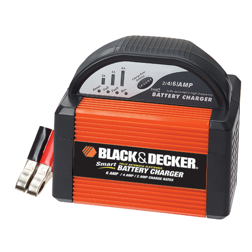

Postby diverguy » Mon Jul 16, 2007 8:42 am
here is my question, maybe mad jack can answer, i have this charger
i have read every thread i can find. and i am not that smart to understand a lot of the technical stuff. so here is what i am thinking.
camping at a nice campground. camper is completely 12v.
plug the charger into the shore power, and turn on charger. go about with my 12v side of life.
so with this charger, can i leave it charging the battery while i run my 12v stuff?
