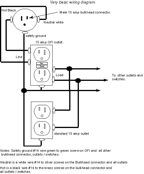

I have read several of the electrical posts, looked at sites, books, etc and I have come up with my "schema". I am very familiar with household electric and mobile electric, but not at putting the two together. I am posting this here for those smarter than me to review. I also have a few small questions that I need answers for.
Here is my schema. Will it work like this?
Questions that I have:
1) Will a 300W inverter be enough? (LCD, DVD, and electric blanket...that is all I plan on running on it)
2) The fuse boxes that I am using are for automobiles. Will that work for the AC side? What kind of fuse should I use (15Amp, 30Amp, ?)
3) Is it worth it to wire the tow vehicle to the battery and charge while I am driving? I have a newer (2005) vehicle that I am sure is smart enough not to charge while off.
4) What do I need to do with the AC ground? I am sure a floating circuit will do and I can just ignore it; am I correct?
Thanks for all of your help in advance.

Postby Chuck Craven » Tue Jan 22, 2008 12:22 am
cfiles
1) 300-watt inverter is to small to run a LCD and DVD player together. More like 600 watts should do. Unless the TV is real small, check the total wattage for both units.
2) You don’t need a fuse box for the AC but wire it for 15 amp service. #14 wire at least. Keep it simple: From a 15 amp male bulkhead connector to a GFI outlet input. Then connect the outer outlets to the load side of the GFI outlet.
3) You need a master fuse for the battery, if you wire a charging wire through the tow vehicle put a fuse close to the vehicles battery just in case!
4) Don’t connect the safety ground to the neutral wire at the GFI outlet. You will have problem with any GFI circuit you may plug in to.
Chuck

Chuck Craven wrote:2) You don’t need a fuse box for the AC but wire it for 15 amp service. #14 wire at least. Keep it simple: From a 15 amp male bulkhead connector to a GFI outlet input. Then connect the outer outlets to the load side of the GFI outlet.
Okay, what do you mean by 15 amp service? Are you talking about just using a 15 amp breaker? I had planned on putting all the 120 on a single circuit. There will only be three outlets in the entire trailer. One in the cabin, another inside a cabinet in the cabin (same circuit). Then there will be one in the galley, right next to all of the service for the trailer.
Chuck Craven wrote:3) You need a master fuse for the battery, if you wire a charging wire through the tow vehicle put a fuse close to the vehicles battery just in case!
I am going to put a 30 amp breaker between the battery and the DC fuse box. If I add a charging wire from the tow vehicle (still undecided) I will do the same to the input.
Chuck Craven wrote:4) Don’t connect the safety ground to the neutral wire at the GFI outlet. You will have problem with any GFI circuit you may plug in to.
Had not planned on it. I figured I would do a basic 2 wire circuit and just ignore the ground completely.

Postby Chuck Craven » Tue Jan 22, 2008 6:30 pm
cfiles
Does this help?
Or is it more :?
Chuck

Postby Alphacarina » Tue Jan 22, 2008 7:22 pm
Your schematic looks like your inverter output and input are the same - You show them in the same place anyway
Your AC wiring and all your outlets should be connected to your shore power . . . . not to your inverter, as Chuck has shown you in the above drawing. All you need for your inverter output is a single outlet positioned near where whatever you plan to run off it is located - You could even get by with no outlet at all . . . . just plug your TV directly into the inverter when you want to watch it off battery power . . . . or go with an AC/DC TV and maybe then you don't need an inverter at all

Postby Chuck Craven » Tue Jan 22, 2008 8:02 pm
You could take a short extinction cord and chop off the male end. Connect it to the inverter. When you want to run the TV / DVD just plug the female connector from the inverter into the male shore power connector and a way you go…. Simple! Easy! No fuss!
