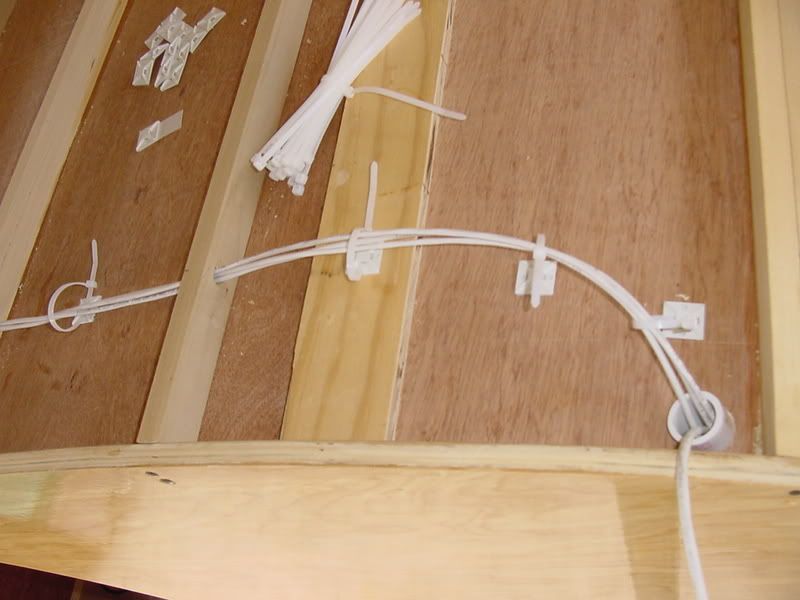

Postby ssrjim » Thu Mar 27, 2008 12:40 am
I go with the simpler is better method.
93079
ssrjim
Posts: 1187
Location: Glendale, az
