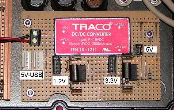

My interior lights are 5v LEDs
My 12V battery drives a DCDC convertor to create the 5V
Even on a completely flat 12V lead acid (say 9V) you can still get enough current for interior lights.
Clive
Just the red box in this picture.
