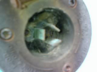

Hi Bianca, do you have a picture of the offending inlet. We can most likely guide you if we have a visual. Installing an inlet isn't really a difficult task. Honestly it is color coded. The difficult part is identifying which wire is which. If you have an electrical chart this will be easier.
Also if you have a picture of the back of the inlet where the wires are connected too....... :twisted:
Or your local RV shop can help out. Doubt if they would charge too much. :thumbsup:
Image to the playground too........ ;)
Postby Bianca Fiore » Thu Apr 30, 2009 10:40 pm
My "local RV shop" is no help at all. I've really tried to work with them, but they think it's too old to be any good and they won't to touch it. They seem to think it's a death trap and I should drive it to a junkyard.
Yes, I have a good photo of the front. I tried to put it in my first message, but couldn't figure it out. I just put a photo pf the plug up on my blog: http://turquoisetrailer.blogspot.com/. Thanks again to everyone for your help! There's got to be an adapter somewhere?

Postby Miriam C. » Thu Apr 30, 2009 11:14 pm
Mike says it looks like what they used to call a crows foot and you might still be able to get a cord head for it. He will try to remember tomorrow. If you don't get an answer to this by tomorrow hit me in the PM. :hammerhead:
Now my opinion, (being what it is) is to get a new one unless you are just hung up on keeping it pure. The RV guys is lazy or he would have sold you on a whole new wiring set up. :R

Postby satch » Fri May 01, 2009 7:56 am
My advise is run an extention cord to the trailer and use a power strip for temporary use, if you don't want to change out the plug. I'm no sure you could fibd an adaptor for that, looks pretty old. Changing that plug should'nt be hard. Why don't you remove it and take pics, we here could walk you though installing a new one.

Postby Bianca Fiore » Fri May 01, 2009 10:34 am
Sounds good! Will a campground allow me to run an extension cord? Thanks! I'll remove it and take pix!

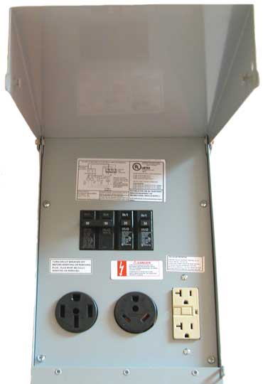

Postby Mary K » Fri May 01, 2009 12:02 pm
Bianca Fiore wrote:Sounds good! Will a campground allow me to run an extension cord? Thanks! I'll remove it and take pix!
That's how we all get power to our campers power inlet, with an extension cord. And tent camper do it like Satch says with a power strip so they can have power in there tents.
Just run the cord in through the door into the trailer and use it for fans and a lamp.
BTW, A camp ground Power Post will look like this...
Plugs for the Big Rigs at 50 amp & 30 amp and 15 amp (like a wall socket you have in your home) for us smaller trailers. A outdoor power cord will work.
Hope this helps.
