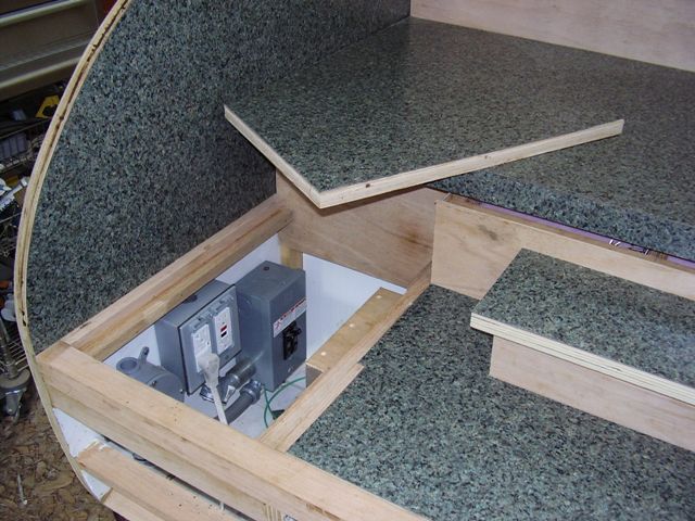

Postby mikeschn » Sun Jul 12, 2009 6:13 am
Easy... run an extension cord to your trailer...
I did something similar here...
http://www.mikenchell.com/Lil_Diner_2_P ... ndex3.html
That big black thing is a gfci... ;)

Postby Larwyn » Sun Jul 12, 2009 8:48 am
mikeschn wrote:Easy... run an extension cord to your trailer...
Mine cost more money, took more time, weighs more, takes up more space and is about the same electrically as the one in the Mike's picture.

Postby caseydog » Sun Jul 12, 2009 9:44 am
My "electrical system" is similar to this. I bought extension cords and power strips to mount inside the TD.
The only cutting and splicing I have is for the power inlet on the side of the TD.
Use heavy gauge cords and power strips. My cord from the pole to the TD is 10 gauge, and rated for 15 AMPS. The cords can get smaller as they reach the end of the line, except for the one that serves the air-conditioner. But, I use 10 or 12 gauge throughout.
