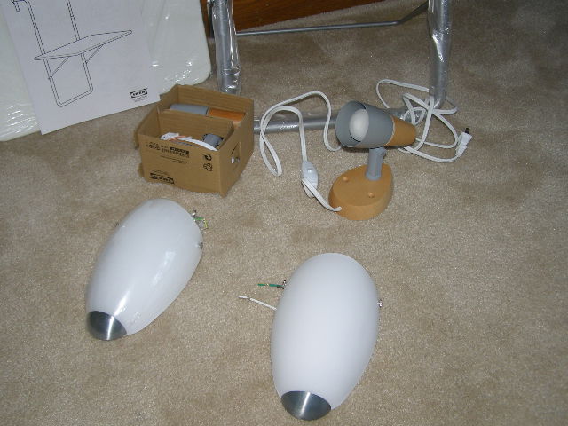

Postby Creamcracker » Sun Jan 17, 2010 4:40 pm
The 2 white lamps above are designed for hardwiring into an electrical system. There are 3 wires that come out of the back ...a green/yellow (which is attached by a screw to the backplate..which is metal) and then a white lead and a black lead. Can I run these wires through a wall then connect to a switch which will protrude back out through the wall... and then attach a longer set of wires to a plug so that I can just have it plug in to the wall outlet? If I do this, do I have to connect all the wires to a 3 prong plug or can I just discard the ground wire altogether. The fixture uses a 40watt bulb max.
Thanks Philip

Postby Miriam C. » Sun Jan 17, 2010 8:13 pm
Creamcracker wrote:Image
Thanks Philip
It sounds like you are wiring a lamp until you talk of a switch.
If I am reading this right then NO! Your switch needs to be on the end with the load coming first.
Suggestions:
Go to a lighting store (that does repair) and ask for information and equipment to do what you want.
Why not hire an electrician to wire this bed for you.
Yup, you can add a three wire cord and plug.
Postby eamarquardt » Sun Jan 17, 2010 8:17 pm
You can certainly add a three wire cord. Ground leads are important (for safely) and it's important to connect the hot to hot and neutral to neutral.
You should really affix the cord to the lamp in a secure way so that any tension on the cord doesn't pull loose the wires from your wire nuts (or even better solder the wires together and use tape or a wire nut-I'm an overkill artist). A cable clamp can be used with a knot in the cord to keep the cord from slipping through the clamp.
As I understand it doing it this way is legal, but given that your fixtures have ground leads you should really use them!! If you want to add an inlne switch I'm sure you can find one that will work. Just be sure to put the switch on the hot wire not the neutral (wrong) or ground (useless).
