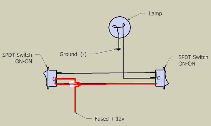

absolutsnwbrdr wrote:^ btw... ignore the bickering in that thread I posted. Go with 2 SPDT (single pole-double throw) switches, and wire them as JoeG had indicated with his diagram.
Cliffmeister2000 wrote:absolutsnwbrdr wrote:^ btw... ignore the bickering in that thread I posted. Go with 2 SPDT (single pole-double throw) switches, and wire them as JoeG had indicated with his diagram.
Bickering? On this forum? Never happens! Justed heated debate between friends with differing viewpoints, opinions, and solutions.
Let's say that Switch 1 is at the bottom of a stairway and Switch 2 is at the top. Suppose Switch 1 is in a 'down' position (B & C connected) and Switch 2 is in an 'up' position (D & E connected). The light bulb is off.
Now someone comes to the bottom of the stairs and flips Switch 1 'up'. If you follow the circuit you can see why the light bulb would now turn on because A & B and D & E are connected.
When the person reaches the top of the stairs, Switch 2 is flipped 'down', E & F are now connected and so the light bulb goes off.
Another person shows up at the bottom of the stairs and flips Switch 1 'down', connecting B & C thereby turning the light on again.
The person reaches the top of the stairs, flips Switch 2 'up' connecting D & E and the light bulb goes off.
Notice that in the case of the second person, a downstroke turns the bulb on and an upstroke turns the bulb off.
If you have such switches in your house OR if you have purchased household wall switches for this circuit, you now see the reason why they do NOT have the words on and off printed on them.
