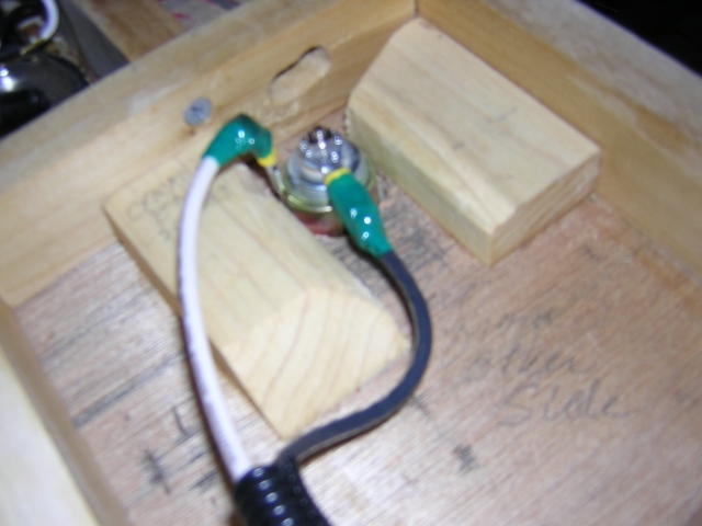

Postby S. Heisley » Fri Jun 04, 2010 1:35 pm
I went out to the garage and took pictures. This first one came out fuzzy but you can still see. This is the one that the question is about:

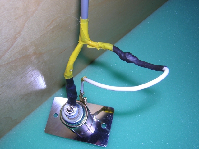

This next pic is of one that is using the extra little neg. wire piece sent by the manufacturer:
PS. Don’t be alarmed at the colored elect. tape…it is only being used to identify the line that the unit is on. Every line is color-matched with electrical tape, for easy identification. (Yes, I've been accused of being 'anal retentive' at times. :lol: )

Postby danlott » Fri Jun 04, 2010 1:50 pm
I think the wiring is fine in the first picture. As a matter of fact I would rewire the socket in the second picture to match the wiring in the first picture. There is no need for the smaller wire. I would assume that you have fuse protection at the other end of the wire. You should not be able to draw more amps than the fuse will allow.
