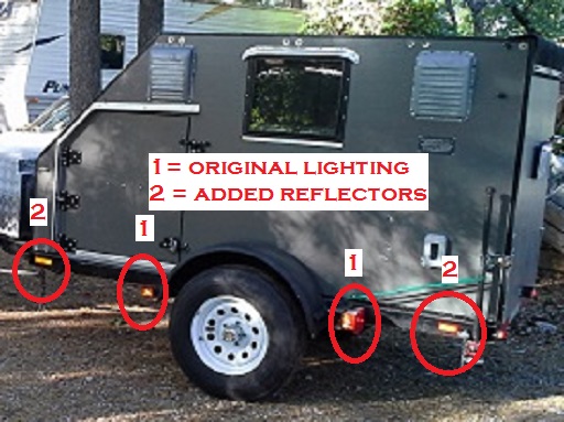

I didn't move my lighting when I extended my trailer 12" in front (not counting the added tonguebox), and 24" in rear. I did add two red lights on the rear bumper rail, and amber front/red rear reflectors at the side corners.
side lighting.jpg (92 KiB) Viewed 11559 times

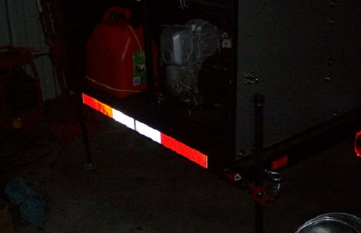

Later, I put conspicuity tape on the rear for better reflectivity at night.
