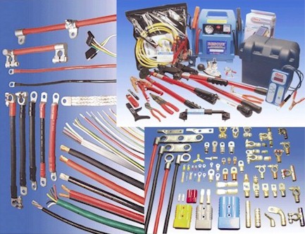

Postby bobhenry » Thu Feb 09, 2012 7:59 am
Any good auto parts store or electrical supply house should be able to fix you up.
Those parts are out here an many are ready made.......
P.S.
If you dont like the colors just paint them with the new "for plastic"
spray paint.
