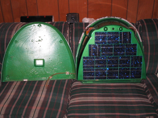

LG, Is this the solar panel that you used?...:
Is it home-made or where did you get it? How hard was/is it to set up? Also, I'd certainly like to see some pics of your teardrop.

Postby Lgboro » Tue Sep 11, 2012 6:38 pm
Oh no, I bought an 80 watt --- that one was salvaged from an old solar mower that WeedEater built and tested at a handful of hardware stores in the 90's. I don't think they made but a few. I have my solar permanently mounted on my tear. I think it was UL Solar if my memory is correct.
I would guess the salvage one is in the neighborhood of 30 watt and I wanted a little more juice.
