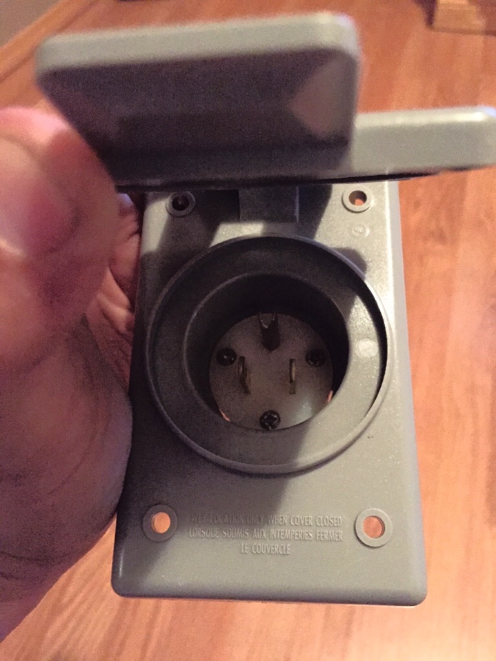

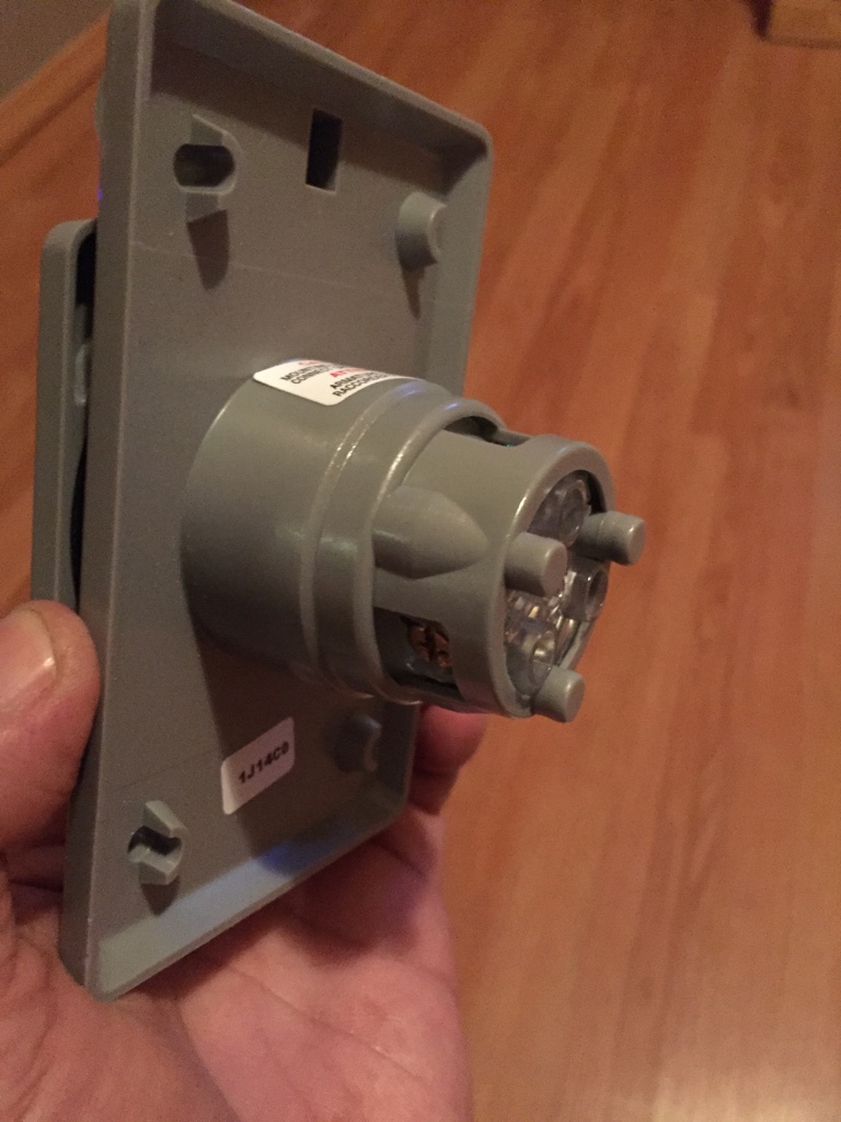

Postby abqlloyd » Tue Dec 16, 2014 12:07 am
Drill a hole. Insert and attach to plastic box on backside. It comes with rubber gasket. I used butyl tape. I backed it with a plastic two-gang cover for rigidity.

Postby abqlloyd » Tue Dec 16, 2014 12:08 am
This is flush to outside of my cargo trailer. They also have a 30 amp version.

Postby lrrowe » Tue Dec 16, 2014 7:55 am
That is the concept I was looking for, but the one one pictured is for incoming voltage I was planning one for outgoing voltage. If i used that, not only are the plug contacts wrong, but it is a safety hazard leaving contacts exposed for one to touch. I was unable to search and find one like that but with a output socket.
Bob

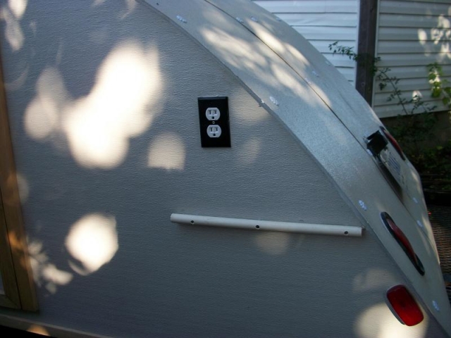

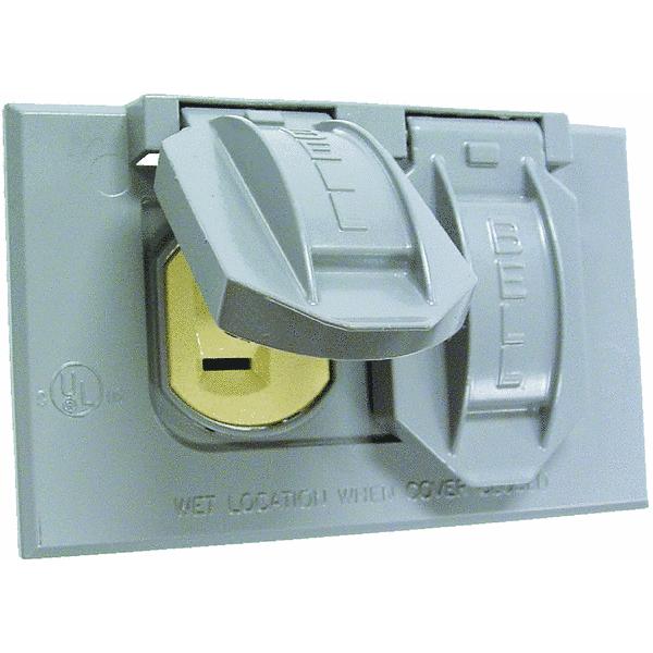

Postby bobhenry » Tue Dec 16, 2014 9:19 am
120 volt weatherproof duplex outlet.......
Re: 120V External Outlet
Postby bobhenry » Tue Dec 16, 2014 9:24 am
I went the cheap route but I did switch them inside in case of heavy rain.

Postby abqlloyd » Tue Dec 16, 2014 9:48 am
I misunderstood what you were looking for. Mine is the generator / 120v inlet. It's never hot until power is plugged in. Everything on the other side is regular outlets. No safety hazard.
