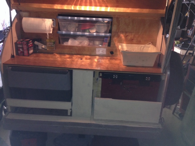

Postby Socal Tom » Sun Mar 08, 2015 12:01 pm
I put mine on a slider under the counter. I pull out the slider when I need to get inside, and in a pinch it becomes extra counter space.
this is a bad picture of the idea. I think there is a picture of it puller out in my gallery.
