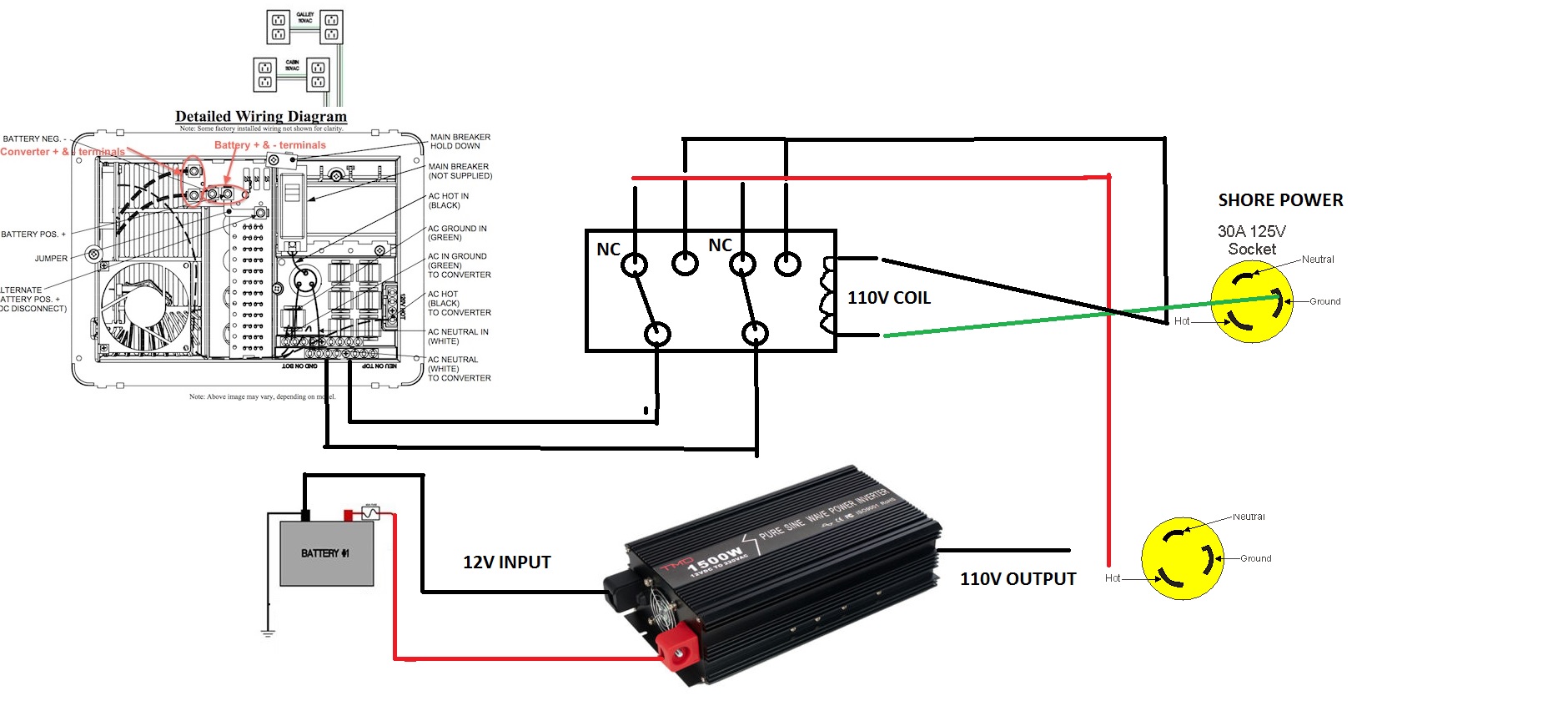

I read through some threads but didn't find what I was looking for. Can someone help me figure this out?
I don't want to run different 110/120 outlets for my shore power and inverter power.
I was thinking that a Double Pole Double Throw relay before the PD4045 could accomplish that. Below are some links to some relays that I think would work.
I have made a crude wiring diagram but I have a couple of concerns on how to run the wiring. It's not complete and I could use some assistance.
When not connected to shore power the inverter would supply 110v through the normally closed contacts.
When shore power is connected the relay would energize and supply 110v through the Normally Open contacts
1. If use a DPDT relay do I need to worry about the converter running on the PD4045 when I am not connected to shore power? Essentially creating a loop from the inverter and converter?
2. Do I need to isolate the converter circuit from the inverter circuit?
3. Will a shared neutral/ground from shore power and the inverter be a problem? How would I tie in the neutrals from the shore power and inverter?
4. Would a better route be just to use an Automatic Transfer Switch? See Link
Relay Links
http://www.newark.com/schneider-electri ... dp/10M6366
http://www.newark.com/potter-brumfield- ... dp/33F1536
Automatic Transfer Switch (ATS)
https://www.amazon.com/Progressive-Dyna ... tch+30+amp
DPDT RELAY.jpg (236.6 KiB) Viewed 5453 times

Re: SHORE POWER & INVERTER USING SAME OUTLETS THROUGHOUT TRA
Postby DWT77 » Wed Jan 31, 2018 7:32 pm
Also I possibly want a 12v/110v ARB fridge/freezer in the future. So I am wiring for it as well.
Will wiring up the trailer like this affect how the freezer senses what power input is being supplied?

Postby troubleScottie » Wed Jan 31, 2018 10:18 pm
A couple of concerns:
1) an inverter draws power even when there are no devices drawing power. You need a switch between the battery and the inverter to turn off when not in use. This switch should be easily accessible.
2) to run simple devices eg lights or usb port/batteries, the quality of the inverter does not matter; devices with motors or electronic devices eg fans, refrig, you really need a good quality sine wave output. This means the cost of the inverter may go up.
3) given the inefficiencies of the inverter and added transition in the frig back to DC, you are better off running the frig directly from the battery rather than the inverter. Obviously if you have shore power, AC is fine.
The electro-magnetic switch might be overkill unless the switch is in an inconvenient location. Then the switch always is connecting to the inverter when the power is off ( see 1 above). A manual switch might be better.
Postby DWT77 » Thu Feb 01, 2018 8:22 am
troubleScottie wrote:A couple of concerns:
This is the specific inverter I have. It has a remote switch I am planning on mounting in the cabin. The inverter will also be mounted in the tongue box.
https://www.amazon.com/VertaMax-Inverte ... 1500&psc=1
This make sense to just keep the fridge on 12v all the time since the battery will be charging while hooked up to shore power
Michael Krolewski.
All of my electronics will be housed in the top compartment of my tongue box
Thanks for the feedback Michael

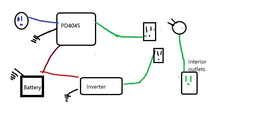

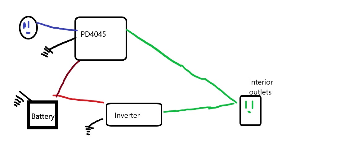

Postby Socal Tom » Mon Feb 05, 2018 10:50 am
I think I've come up with a simple solution.
This drawing is what I think you probably have now.
Standard Wiring.jpg (39.78 KiB) Viewed 5230 times
Have the PD4045 output feed a 120vplug ( this will reduce the number of circuit breakers you can use, but how many do you really need on a TD?)
Have the inverter feed a 120V plug
then have a secondary cord that feeds the interior outlets, and plug that into the source you need like this
convertible Wiring.jpg (51.64 KiB) Viewed 5230 times
You will have to excuse my crappy drawings.
Or is that what you drew and I just didn't get it?

Postby DWT77 » Mon Feb 05, 2018 1:01 pm
Socal Tom wrote:I think I've come up with a simple solution.
You had the top drawing correct
I think at this point I will just move forward with having inverter outlets and shore power outlets.
Thanks for your feedback and taking the time to help me out!
