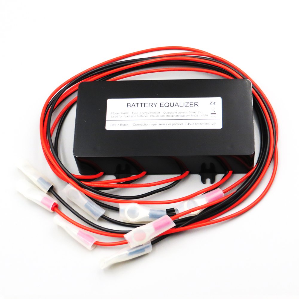

I have 4 6v Golf car batteries in series/parallel configuration got 12V 430Ah of capacity and charge with 500W of solar through a 40A MPPT controller. Will the following device work to balance the charges? It says it is for 12V.. but some of that data suggest it will work much lower.
Anyone have any experience with this Golf Car Battery configuration and using a Battery Balancer to ensure an even charge? Any help appreciated..
Details:
https://www.amazon.com/DPJ-Batteries-Eq ... y+Balancer
Don (Flboy)

Flboy appears to be asking about a battery balancer (for batteries wired in series) not an equalizer.
I had no idea about this subject until I read the article at
https://en.wikipedia.org/wiki/Battery_balancing
My initial thought is that the “positive” type would be better than the “passive” type.
Per the article:
“In passive balancing, energy is drawn from the most charged cell and dissipated as heat, usually through resistors.
In active balancing, energy is drawn from the most charged cell and transferred to the least charged cells, usually through DC-DC converters.”
I wonder how the the unit flboy originally posted about works?
Given that I know so little about this subject matter, I am hoping flboy or somebody else can help figure this out.

Postby flboy » Tue Jan 08, 2019 8:18 am
Thanks all for replies. I am just learning about all the subtleties of proper battery maintenance as I go here.
I do believe the balancer unit I posted is the passive type for that price.
If not needed for SLA batteries I am probably all set then.
I will continue to read up on the topic, but I suspect the practical vs. theoretical sides may differ some and I am all about practical! :-)

From the Description and at the bottom it says it is suitable for Lead Acid Batteries. The description does not talk specifics... but that was the purpose of my post and questions.
It is obviously a foreign translation with poor use of English. What caught my eye was the discussion on imbalance and the series configuration which I have moved to in my CTC.. Victron and others make versions of the same device.
Description
Specialized for keep up the voltage balance of batteries connected in series during the Charging and Discharging process, due to differences in the chemical composition and temperature of the battery cell that connected in series, It causes two battery charge and discharge differences even the battery is idle, also due to the different levels of self-discharge could lead to an imbalance between serially connected battery at charging process, because there are differences, it could make a battery excessive charge or discharge, and the other one insufficient charging or discharging.
HA02 battery equalizer is suitable for Lead-acid Batteries(VRLA), Lithium Iron Phosphate Batteries(LFP), Nickel Cadmium Secondary Batteries(Ni/CD), and Nickelmetal Hydride Secondary Batteries(Ni/MH). It starts work when the voltage higher than 2.4V, it means that this equalier can be used in a single cell battery range from 2.4V to 12V. One equalizer can connect 4 batteries once a time, if battery less than the 4, the extra cable can be vacant (positive and negative terminal should be avoided), does not affect the equilibrium effects. The equalizer is not affected with battery connection way,  no matter in series or in parallel, both can work.

Postby bdosborn » Wed Jan 09, 2019 8:07 pm
I don't understand how it helps. You might be able to overcome the internal resistance of each battery and charge it to a bit higher level but not much since the batteries are still connected to each other and as such must all be at the same voltage. Then it seems to me that the batteries are going to discharge at different rates (per internal resistance) and equalize to the same voltage level across the array as soon as you apply a load. The unequal discharge rate would be compounded by any difference in resistance across the battery conductors due to different lengths. In short, the batteries are going to quickly seek their own charge level during use.
So how is it supposed to benefit your battery bank? Not trying to troll, I'm always on the look out for a new battery gadget. :D
