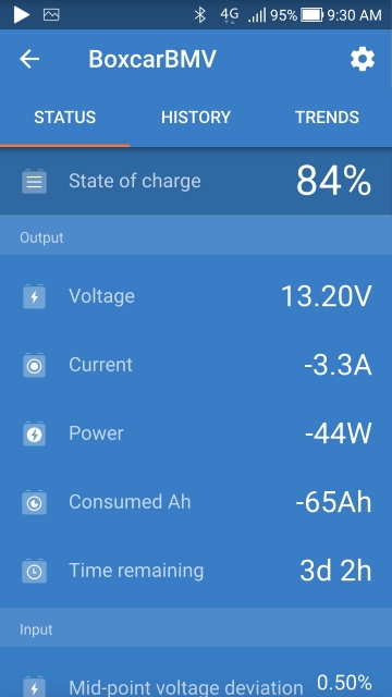

I love the Raspberry Pi that connects to my Victron battery meter and solar charge controller. I can access the info over the web and see summaries of our power use. I also get email notifications if the power goes out so I don't have to worry about my battery going dead because the trailer got unplugged or something. The Raspberry Pi logs data when we're camping and then connects to our WiFi when we get home to upload the info.
I can connect using my phone and Bluetooth when camping to see a bunch of info too.
Victron is definitely the best IMHO.
