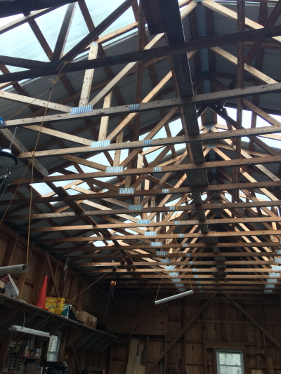

Postby pchast » Sat Apr 23, 2022 4:53 pm
Clear panels in the same style as the roofing done 17 years ago.
No leaks yet. Its as bright as outside without lighting.
