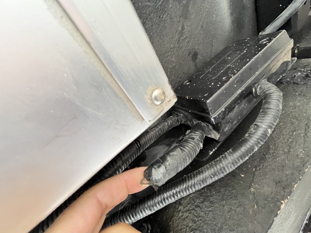

Question: If I disconnect the ground that's attached to the chassis (this is the ground that is comes from the 7 pin connector into the trailer's junction box..... I tapped off from that ground and made a separate ground to the trailer's chassis) .... if I disconnect that ground wire temporarily (see attached pict) ......and put a probe from a multimeter into the ground contact on the 7 pin connector and touch the other probe from multimeter to chassis frame, should the meter see continuity? It is. The only place I'm thinking there could be a ground connection to the chassis would be the brake's themselves, the ground wire and blue wire connecting to the electro magnets.... producing a ground connection to the chassis. Does this sound as it should be?

Postby twisted lines » Wed Nov 30, 2022 12:04 pm
Should the meter see continuity? It is.
It will if you grounded one light bulb, fan ect, to the chassis.

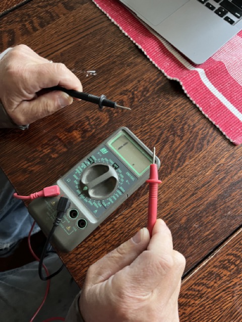

steve cowan wrote:Have you done an ohm check of the brake coils.Should be 3 to 4 ohm range.Check seperately.
I have..... and I hope I'm doing it correctly, the testing. On each brake magnet I don't get any reading at all. My meter shows "0.0".
If I touch the probes together (one on the other) I get a reading of .5, sometimes .6, just to see what the resistance in the probe's wiring is.
So I'm thinking the windings in both magnet's coils are open (broken). I'm not sure why or how that came about .... if in fact that's the issue. I have an appointment with a trailer shop on Thursday to get another set of eyes on the problem.

Does your ohm meter read 0.0 when the probes are apart? I would expect it to show infinite resistance, not zero resistance in that case. Same if the windings on your brake magnets are open.
0.5 to 0.6 ohms resistance on just the probes themselves also seems high. Or is it showing milli-ohms or something?
I suspect something is wrong here. :thinking:

Thanks Tom. When the probes are apart the meter does show "I" (infinite resistance).... when the probes are touched together the meter shows 0.6, sometimes 0.5...... I have the setting on 200 ohms (see attached). When I put one probe on one of the magnet wires and the other probe on the other magnet wire, it shows 0.0... so this is why assuming the coils in the magnets are broken somewhere. A puzzler.
