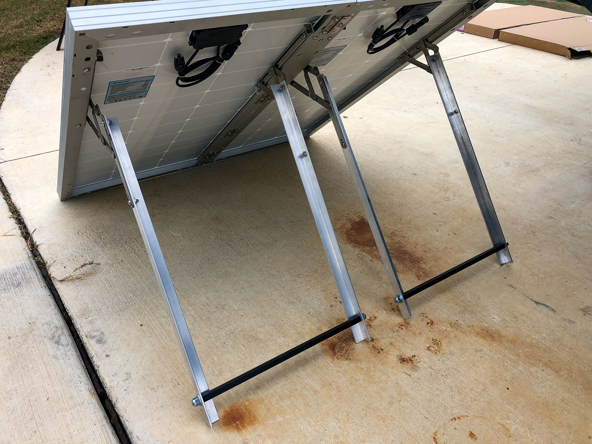

Postby RJ Howell » Mon Jan 15, 2024 8:53 am
Found a picture. You went a bit more elaborate then I did. With a notch in the angle iron it limits the angle. Like I mentioned, I like landscape better, less of a wind catch.. Folded nice and flat.
