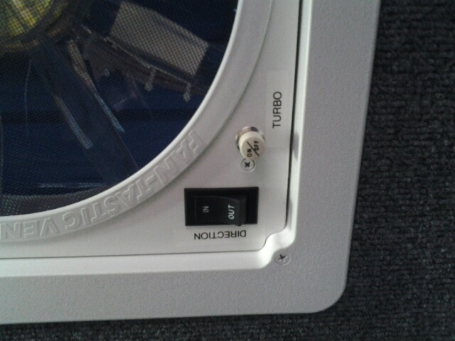

I have actually done another modification since my last post. I added a push button switch to by pass the ballast resister. I now have six speeds. I labeled the button turbo. Now I have more fan speed option then I know what to do with.
