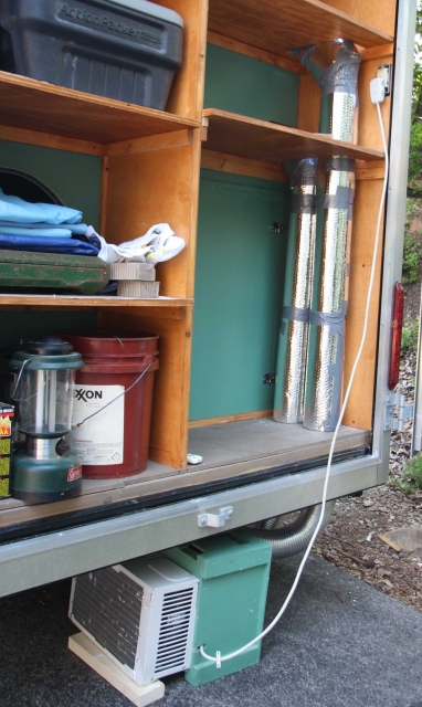

Postby lrrowe » Sat Jun 11, 2016 3:57 pm
capnTelescope wrote:You're forgiven, Bob. :D
Only a few months late Brad.
Here is my unit and compared to many others, it is very crude.
I installed it yesterday and with this 95 degree day here, I cannot get the Inside temp below 74.
I think I need to follow Shadow Catcher's blower idea to help move the cool air faster.
Bob

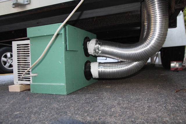

Shadow Catcher wrote:I just completed the adaptation of a 5,000 BTU Frigidaire to work with Compass Rose. This was actually a very inexpensive process as I used a close out Frigidaire 5000 BTU that I picked up end of season at Lowes for $50. I had an adapter made to handle a 4 inch ducts by one of the local heating and air conditioning contractors. I had originally thought of using a rather fancy digital thermostat but found that making it play well with the air conditioner was not going well, plus every time it was unplugged I would lose all the settings. What I ended up doing was pulling the thermostat out of the AC unit and mounting it and on off switch in a RadioShack project box. Wiring is very simple because with a thermostat all I'm doing is looking into the existing wires that control the AC unit, and the power switch basically interrupts the off, cool, fan speed switch. I figured that the unit would be on high cool all the time, or off as I am pushing air through 4 inch flex duct. Control wires are connected using Anderson power poles and run through the air intake duct. The ducts run through four-inch Marine deck plates in the side of the trailer.
I ended up having a serious problem with the initial set up and that was icing and the discussion of that is much later in the responses on page 3. The solution however was quite simple, I added in a 4" marine bilge blower rated a 240 CFM and this has taken care of the problem. The pictures are at what is currently the bottom of this first posting. I do need to refine how this goes together and I will edit the final solution. my feeling is that I can reduce the speed of the blower and the noise produced and now that I know that it works shorten hose and route wires neatly and efficiently.
This is the electrical guts, VERY simple, Note the absence of the thermostat.
Here are the housing and adapter prepped for paint.
This is the inside of the adapter. Note the felt strip to seal the opening to the AC
The duct is the same one I used for the diesel heater good up to 450 degrees and you can see the plastic reducer wrapped up with closed cell neoprene to achieve a watertight fit.
Here is the finished adapted unit plugged into a GFI outlet. Note that the AC unit can sit entirely underneath the trailer.
On the anterior I used standard RV type duct outlets that have a wide enough spacing to allow me to run the control cables through. And yes I need to box in the outlet.

Crossroads of America Gathering was the real life test of the system with temperatures in the upper 80's high humidity and no breeze. Saturday night it did not cool off much and we left it running all night. Come morning it was covered with condensation and you can see that.
The bilge blower is three speed, full, and with the use of resistors in the negative line, medium and slow. I found that the slow was sufficient to overcome the restrictions in the air movement enough to prevent freezing. My next step will be trying a PMW to regulate speed. The resistors get HOT and while I sandwiched them between a couple of pieces of aluminum to help dissipate that I hate wasting that much energy.
The latest is that I wanted to see how it withstood weather so left it attached and running and exposed during a thunderstorm with no ill effects. The PMW works great for regulating the blower speed, until you cross wire it, I will be getting another one this week.

I hooked my system up yesterday and it is not cooling as fast and as deeply as it did for me last year with my mock up setup.
Now I come through the bottom thru about 2-3 ft of pipe, then up about 4 ft to my vent. I am wondering if I am trying to have the small AC unit push the cold air too far to maintain an adequate air flow. I am wondering if I need a bilge blower like yours, but to push the cooled air not pull the return/warm air?
What do you think?
Bob

Hey Bob, I'm not SC of course but I'd be willing to bet the added duct is your problem. The airflow/cfm of the window units aren't the greatest in the world in the first place, by adding the extra 4 ft of pipe and the vertical rise you've created a problem, the blower in that window unit just isn't designed for that. A booster fan will give you more air but will also change the temp of the air that comes out, ie: warm it up. A speed controller on a higher cfm computer type fan or just a lower cfm fan is your best bet. Use a thermometer and see how drastic the temp changes the more air( faster) you run the fan and adjust accordingly.
