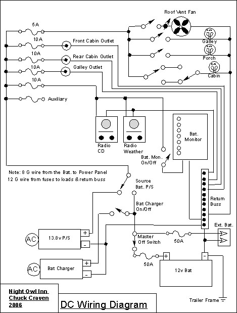

packerz4 wrote:
Alphacarina wrote:. . . . but then I really think you would be happier using a small battery in the long run - You can't always plug it in ;)
Don
ok, i'm being sold on the battery thing. i like what Arne said too, about the times when you'd like the light to work, like a rest area etc. Soooooooooooooooooooooooo
how do I hook all the 12v light wires onto a battery?
i will have a battery charger hooked to the shore power, and the charger hooked to a small battery, then how do i connect the lights to the battery.... one huge pigtail and a connector?
thanks in advance. i think i'm going to be way happier with this set up than my current one.
tk
Will this help?
Chuck
