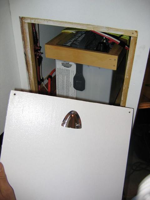

Here's mine. Only 12v no 240v (Aussie so not 120v)
The battery (100AH fully sealed AGM) is in the galley under the bench with a marine switch panel to turn on the main sections of power. For something a little different the battery and panel are on a draw slide for easy access to the wiring. It will lock in place by via a latch on the side accessed by taking out the draw next to it. Anway, the pics.
Three separate circuits, each with it's own circuit breaker. Switches etc are all splash proof. There are also two power points, one is a hella plug to run my compressor fridge (Waeco 50lt, fits on top of the bench or just on the ground, when traveling its in the Jeep), the other is a standard cigarette lighter style.
Battery tiedowns not on yet, the draw slides in on to some additional nylon runners under it to take the load off the runners themselves on the bumps etc.
The wiring in the TD itself is split into the 3 circuits and can be turned on individually at the rear panel and obviously switched at each light point etc.

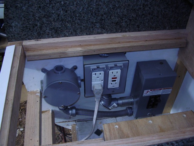

Mine is no showpiece but here's a shot of the AC side;

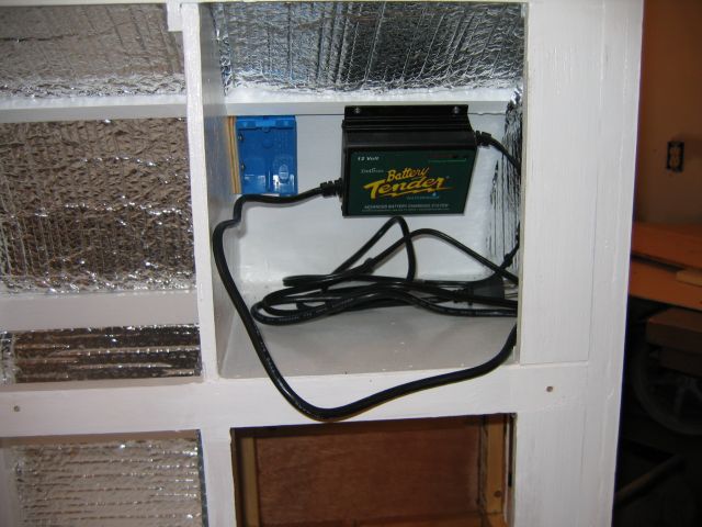

And here's the DC side;

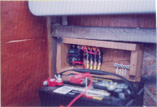

4 DC circuits right side left side front and galley breaker / disconnect on left then 4 15 amp glass fuses all grounds return to grounding bar on far right. Ain't fancy but it was cheap security.
And I know the wood box is probably not fireproof :lol:

Steve F wrote:...The battery (100AH fully sealed AGM) is in the galley under the bench with a marine switch panel to turn on the main sections of power. For something a little different the battery and panel are on a draw slide for easy access to the wiring...
Very slick setup! :applause:
Not considering whether or not the wiring consequences of the moving panel might be a concern, the mounting setup is compact, accessible, and just clever.

All ya have to do is make a large loop of the wires and wrapped them this spiral wrap.
And the drawer should open without any damage to wires or connections. we do it all the time here at work for our instruments that slide in and out of the racks.

I'll also be using that spiral wrap, realistically though the draw will only be pulled out when it comes time to charge the battery. To get around this requirement I'm thinking of getting a 30A socket (overkill really as my charger is 16A but better to be safe) and mounting that somewhere, along with a 30A plug and chopping the battery clamps off my charger and putting the plug on instead so I can just plug it into the socket and charge through that. It will also give me a high amperage output as well if I need it. This way the draw will never need opening other than for the occasional maintenance check :)

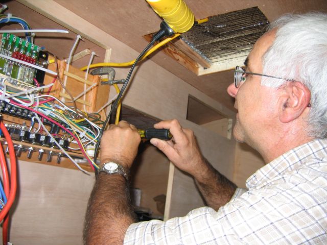

Here are some hightlights of the electrical work on the windsong TD

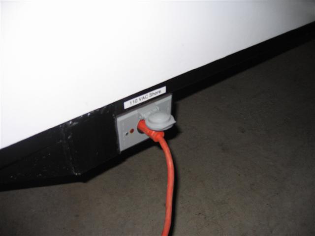

Here is the inlet
Here is the wiring bundle for trailer lights and 110 volt inlet feeder

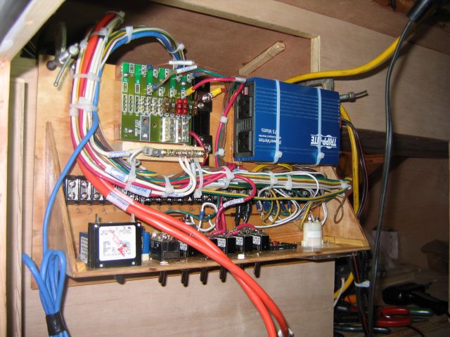

Here is the basic panel
Making panel connections

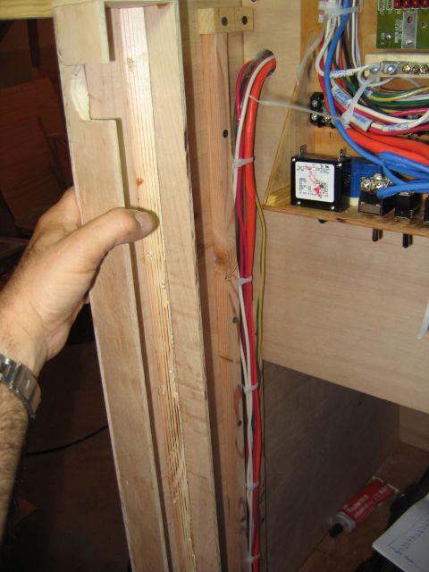

shown is the raceway wiring coming up from below the floor.
Progress! Notice labels to help in any future troubleshooting.

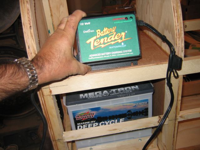

Battery in tongue box construction
More battery storage pictures

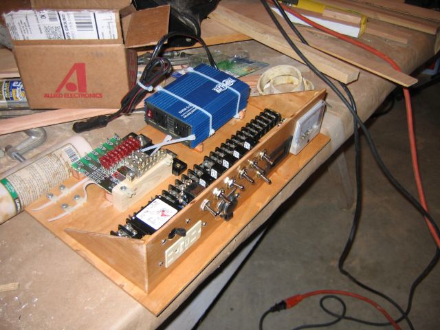

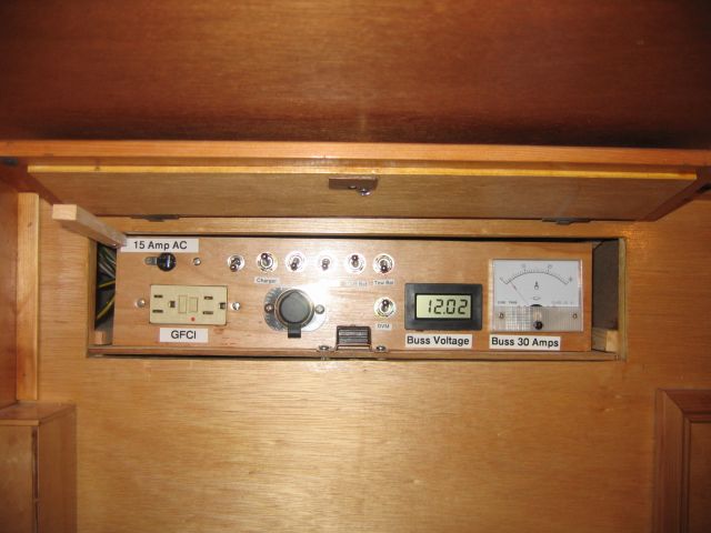

Completed power panel with digital voltmeter and 30 amp Ammeter to monitor battery usage and charge. There is also a 15 amp breaker for 110 vac shore power an GFGI outlet and 12VDC outlet. The switches work interior and exterior 12 volt lights. DC connection to either 12 VDC automobile electrical system or TD Battery if automobile battery switch and the TD battery switch are both in the on position the TD battery will be charged off the automotive electrical system. There is also a switch that turns the digital voltmeter on and off to save the 9 volt battery that runs it. There is also a switch that controls a 175 wat invertor to run small electronics. I have been using this for two years without any problems.
