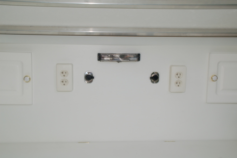

Postby wlooper89 » Tue May 12, 2009 12:29 am
I used 20A outlets for the four in my trailer with #12 wire. The galley ones are shown here. I like the way the connections are made on these outlets. I used a 30A power inlet and cord from the campground power pedestal and then split into two AC circuits with GFCI and a 20A CB on each circuit. There are a lot of different ways to do things and this was my choice. I am still limited to 30A total by the pedestal CB but can put up to 20A on one circuit. I learned the hard way that using two 20A rated GFCI from Home Depot or Lowe's is quite a bit less expensive than a single 30A one ordered online.
