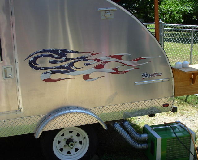

I haven't had any problems with my Marinco plug either but then it's placed just forward of the galley hinge and is always protected by a shelter. Placing it under the teardrop isn't convenient for me. Makes me think a piece of the "J" shaped drip molding bent over the inlet would help keep water off it. I'm with others and think your power source may be the culprit. :D Danny

Like this...? Mine isn't the Marinco but it's similar. Has a rubber/neoprene seal inside but I figured the 'J' rail wouldn't hurt either. No leaks in 3yrs & 10K miles & all kinds of weather -

That's it.
A man who's thinking of & correcting problems before they happen. :thumbsup: Danny
