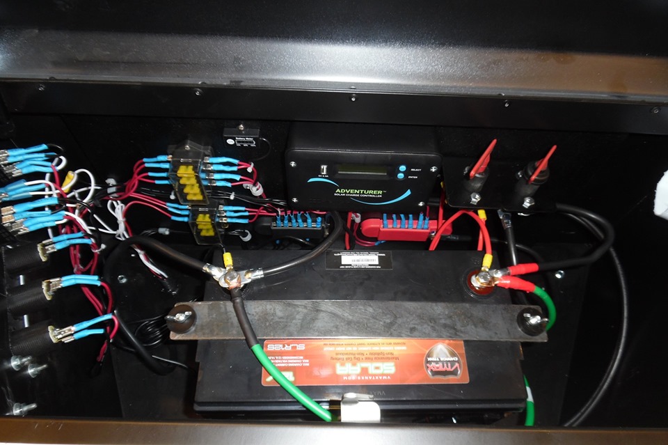

most of my wiring 12v., solar is in the tongue along with 55amp Powermax Converter Charger, 3 12v. outdoor light switches, 3 12v. outdoor socket outlets, 2 shut-off switches one for the 12v. & the other for the solar. The Powermax Converter wire are ran from the inside of the cabin down the wall under the floor into the tongue box, the interior lighting wires & the 3 exterior courtesy lights all 12v. is ran inside a wire chase that is plastic & matches the birch plywood that runs to the tongue box. My a\c is connected to powerstrip that can be connected to shore line power 110, or off generator
