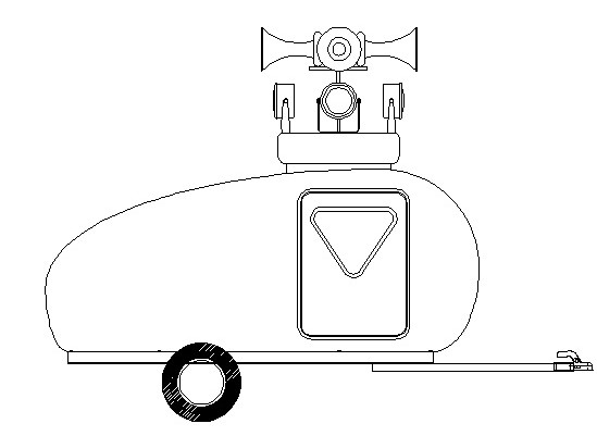

Larwyn wrote:I have a plan for defense against loud music and bright lights invading my campsite. Drew this up a few years ago........
:lol: :lol: I wonder that would do to your gas milage :lol: :lol:
