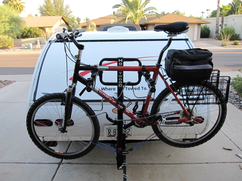

Postby Oasis Maker » Mon Dec 13, 2010 9:49 am
Tumbleweed_Tex wrote:Um…
After looking at the photos in your album, Scott, it seems to me the simplest solution is to just raise the bike about six inches.
:roll: Um, I'm not sure I agree with your assessment, but I appreciate your input anyway. ;)
Seriously though, the bike below is covering more area of tail light than just 6 inches, and this is my small bike. My larger road bike covers even more of the tail lights with its 64cm frame and 700c tires (it's a big bike). On top of that, there's even more of an obstructed view of my tail lights from the higher viewing angles of truckers, SUV's etc.
It would be nice if a simple hitch riser adapter would completely solve the problem, but it won't. I'm actually very optimistic about Rob's idea. It doesn't seem to be a big deal to install and I will actually like the added function without the bike mounted. I ordered the dual bulb lights and will hopefully get them before the weekend.

Thanks for the rear view pic above of your setup; I hadn't seen it before.
Silly expensive - due to weight bearing specs - and not the unit I'd seen before, but here's a 2x Adapter:
http://www.campingworld.com/shopping/item/4-dual-hitch-receiver/34685
This fellow has some nice ideas, including his tricked out Receiver mounts:
http://home.comcast.net/~netboy/#ElecHeat
In his Index, see pix 'Fabricate Custom Rear Steps'; 'Build Platform For Honda EU2000i Generator'; and 'Fabricate Front Bike Rack'.
One solution that would be seen above the fully-loaded Bike Rack would be a 'T' piece of metal that slips down into the square stock above the letter 'H' with the black plastic plug there popped out. The lights would mount or stick on the horizontal part of the added 'T'.

Why not adapt a roof rack Bike rack to the Tear. They face forward and obstruct less in the rear?

I definitely wouldn't want to do a front mount with my bikes. That position would just likely switch the obstruction problem to the front lights and the road debri would be damaging to the bikes.
Some sort of additional magnetic mount tow bar like you and Larwyn have mentioned would be a good additional project. I'm assuming that the connection is 4 prong just like the front, but where do you make the actual splice at for wiring? I'll try and google some images.

Postby Oasis Maker » Tue Dec 14, 2010 7:19 am
DIY-Stu wrote:Why not adapt a roof rack Bike rack to the Tear. They face forward and obstruct less in the rear?
You've touched on the 64 thousand dollar question . . . well at least the 400 dollar question. I already had $400 invested in the rack I have now and it is a very good rack, BUT, I have long considered putting a dedicated roof rack on top of the tear.
There are a couple of other things that I'd like to do that could even be incorporated into the structure. One are solar panels. This is something I really want (need) in the future to run a fantastic fan, etc. I'm thinking that mounting a long solar panel on one side of the roof rack and having the other side for a bike might be pretty smart.
However, I am a little concerned about the amount of weight up there and structural integrity. But therein lies my future conundrum in perhaps the not too distant future.
