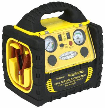

The out outdoor charger is a 40 watt Kyocera Mono Crystalline solar panel =)
The red thing on top is a jump-start battery and the silver thing on top is the solar panel =) I like them and use them dry camping and emergency radio communications when needed. When they die ; I replace the battery inside with another one when they are on sale and keep the shell ( recycle them =) They have an LED light / air pump / 120 AC inverter / jump-start cables / 12 outlets =)
