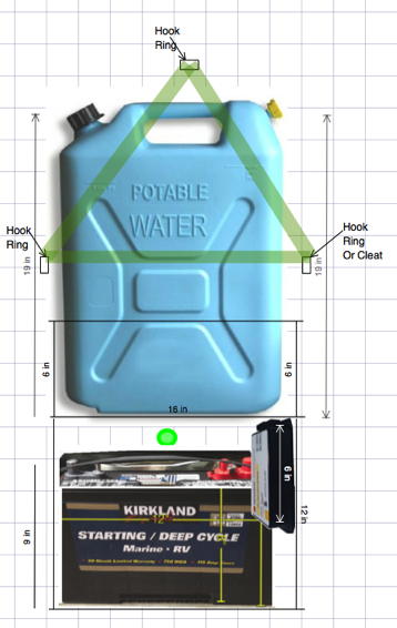

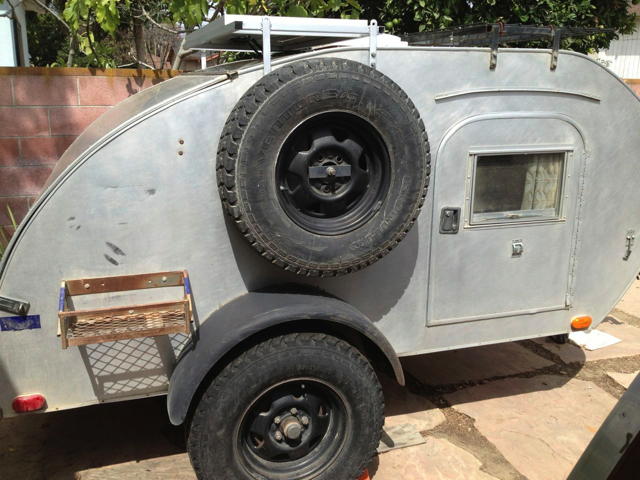

I've traded in my old AGM 30AH battery for a 115AH flooded deep cycle marine battery from Costco. The battery was $95 and holds about double the power for the size, compared to the AGM battery I had. (a pair of Optima 55AH yellow top batteries will cost like $500) I've just about convinced myself to weld up a gas/water can rack for the side of the TD, and hang the battery box from that. The only place I can put it is on the driver's side, just behind the axle. I already have a water can rack & spare tire on the passenger side.
Actually, now that I look at the drawing, all that may not fit. And I can't put the battery too low, or it will get smashed on a rock sooner or later. Hmmm.... Well, the water can might not fit right there, but that is where the battery is going... Unless I decide to put the battery on the drivers side over the axle, where the water can rack is now. And the coca cola bottle opener may need to move. Um, still a bit of flux in the battery location plans.
The battery box will vent to the outside, and the charge controller will go in with the battery. The instructions for the Genasun 10 Charge Controller (CC) say to put the CC near enough the battery to sniff the battery temp. In the case of the battery overheating, the CC will stop charging the battery until it cools down.

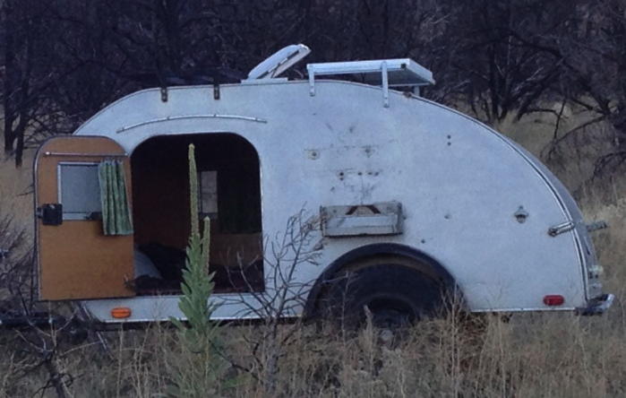

Really didn't want to give up any precious cargo space. Didn't want to use a non-structural plastic battery box either. So I built a sturdy metal battery box attached to the drivers side wall, near the back. This also meant that I could safely use a flooded battery, which holds about twice the power for the same size as an AGM battery. And way cheaper too. Designing & building the battery box was a ton more work than I expected, but I'm pretty happy with it.
Here is the whole Solar Fridge project build, including the battery box: http://td.roughwheelers.com/2015/solar-fridge-project
