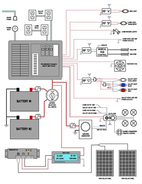

Here's my overall wiring plan, showing my dual battery disconnect switch. The PD4045 is in my electrical compartment at the head of my bed. The batteries are about 4 feet away, hanging in cages under the trailer. The switch is located about 12" from the PD4045, but there are also inline fuses within 6" of each of the batteries positive post terminals. 10GA hot wires from each battery come into the switch, then one 10GA hot wire runs into the PD4045 and is connected to the hot lug of the DC side. The solar charge controller is hooked into the main DC hot lead of the dual battery switch. 99.9% of the time, my dual battery switch will be set on "1&2" (using both batteries), but connecting the solar panel to the main lead of the switch lets me completely remove a battery if I need to, yet still keeps the solar panel connected to the other battery.

Postby Esteban » Sun Jun 01, 2014 1:07 pm
:thumbsup: Zach thank you for your detailed reply. I think SOME of the confusion comes about because each of us is setting up our electrical systems differently to meet our own needs. I wish I had the ability to visually draw up my plan similar to how you have drawn up yours. I've tried to learn to use SketchUp to no avail so far...I'm still in the deep confusion stage when I attempt to use it.
:thinking: Your two illustrations seem to differ (in my opinion). Your top one shows the second breaker from the left as a "converter breaker". Your lower one shows a 15A breaker in the same position powering an AC circuit with two AC outlets...which is how I (think) I will set up my wiring.
I purchased four AC breakers to fill the four locations in the PD4045. I have one 30A main breaker and three 15A branch breakers. None are dual breakers.

Postby absolutsnwbrdr » Sun Jun 01, 2014 10:54 pm
The second image was drawn before I drew up the detailed PD4045 wiring diagram, and was really on there for graphical purposes.
I read your post and I just still don't understand how you plan on getting power from your shore power inlet to your DC converter/charger side of the PD4045 without using a breaker. Ignoring the size of the power inlets, number of batteries, all the solar panels, charge controllers, LED's, stereo, etc, AC power still has to be fed from the right half of the PD4045 to the converter/charger on the left side. With no AC fed to the left side, your charger won't charge and your converter won't convert. :thinking:

Postby absolutsnwbrdr » Tue Jun 03, 2014 9:50 am
Esteban wrote:There are other ways to wire it, without a second breaker used as a converter breaker, that I am attempting to learn about.
I'd be very interested in reading about that.
The only other way I can think that is even possible (although I have very very serious doubts as to its correctness) is to connect your shore power hot (black) directly to the bus bar that the breakers plug on to. This would let you use your 30A breaker for your converter, and then use your 15A breakers for whatever branch circuits you have. (I strongly suggest against this)
HOWEVER, the PD4045 instructions specifically call for a 30A Main Breaker for a reason.
By definition, a main breaker's purpose is to work as a disconnect for 100% of the AC power going to an breaker panel (the PD4045 in our instance). Connecting the shore power directly to the breaker bus bar as I just described above completely defeats the main breakers purpose and I have zero doubt in my mind that this could void any warranty on your unit because its not wired as designed.
Not to mention that the PD4045 converter/charger doesn't require anywhere near 30A. Per the instruction manual, its rated input at 105-130VAC is only 725W, which is a maximum of 7A.
If you really need want more than two AC branch circuits for outlets then pick up a few tandem breakers and do it right. They're just about twice the cost of a regular breaker (because it really is two breakers in one). That will allow you to have the maximum of a 30A main, a 15A converter breaker, and six 15A circuits for outlets. Why anyone would need 6 branch circuits in a tiny trailer like ours is beyond me.
I know you're planning on using GFCI outlets which is a good thing. You can daisy-chain multiple outlets on each branch circuit, and only the first one needs to be a GFCI. So the more circuits you separate your outlets into, the more GFCI outlets you'll need (more $$). Unless you have some really big items pulling some serious power (at exactly the same time), then you'll be best off keeping your AC branch circuits to a minimum for ease of wiring and to keep costs down. I don't know exactly what your plans are, but there's really no need to run an individual outlet on each branch circuit.
For example: MAYBE if you're planning on running a full size microwave (~1200W @ 10A), a heavy duty coffee maker, and a 1000W blow dryer (~8.3A) at the same time, then you might separate these circuits onto their own breakers. But that's probably an exaggerated situation for someone who is camping. I know some people have microwaves, but I've never seen someone with a full-size microwave.
That's all I have to say about this subject. I really can't explain it any better. Just trying to help KISS. :thumbsup:
