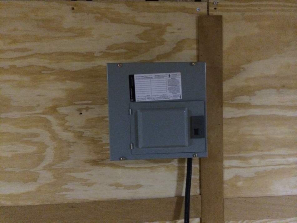

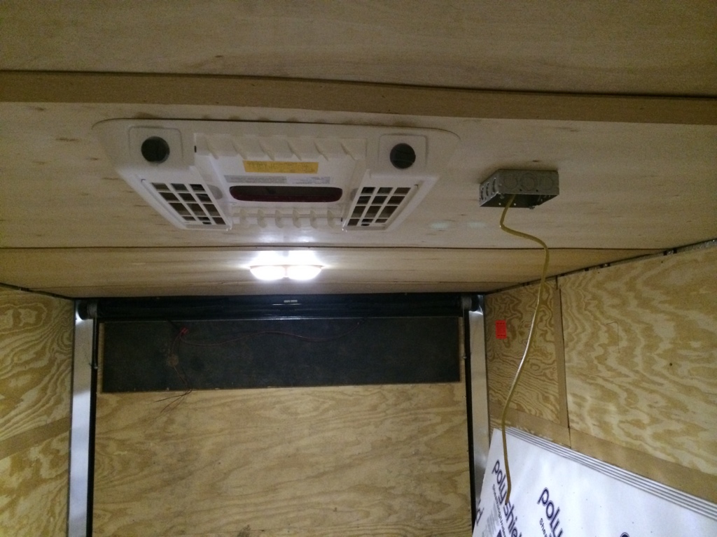

Thanks for all the info I have decided to wore it up in conduct and on the outside of panels. I have used number 10 wire from outside 30amp plug to breaker panel. And I'm running number 12 wire to all plugs and the ac. All on 20 amp breakers and all stranded wire. I got 20 amp plugs where the wire slides in them.
I am going to have every light on dc and I bought A 12 spot fuse block I am going to use the same number 12 wire for all my dc to and stick 20 amp fuses in there as well. I'll get pics up soon thanks for all your guys help
