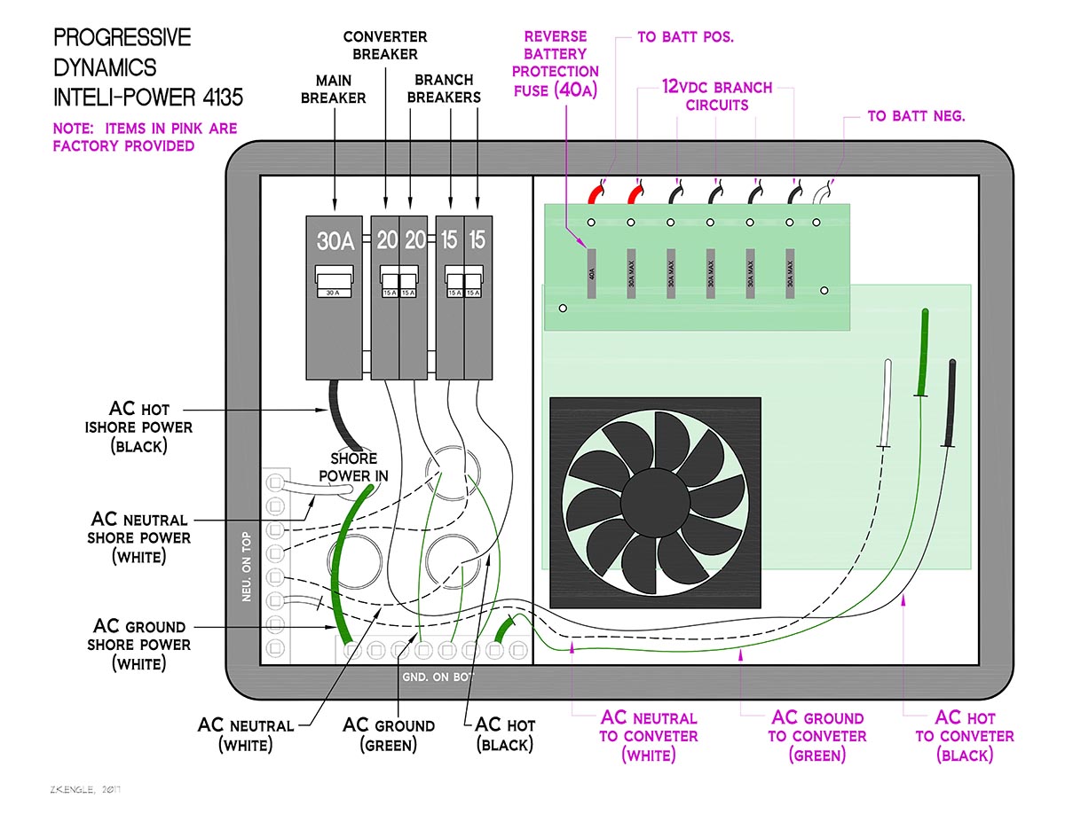

Just got a pd4135 trying to finish up the wiring using the pd diagram here https://www.progressivedyn.com/wp-conte ... manual.pdf . probably an obvious question but bear with :D What am I supposed to do with the wire labeled 'CONVERTER HOT (BLACK)' in the diagram? Appreciate any info thanks.

That goes to a 120v circuit breaker. I wired mine into a 15amp breaker. So first breaker slot is a 30amp for hot coming in. I used second slot for 15amp converter hot, then used the third slot for a another breaker supplying power to outlets.
PD4135 Wiring-sm.jpg (176.16 KiB) Viewed 9831 times

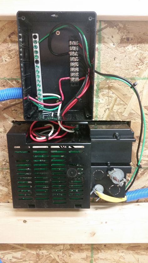

I am in the middle of installing the PD4135 and have a similar question. I installed a small project box above the back of the PD4135 cabinet to route and connect the 12 VDC wiring. I installed a ground bus bar to connect all of the ground wires from each circuit, converter, and battery. I also installed a terminal block to make it easier to connect the wires from the converter to the TD circuits. I attached the positive (10ga Red) wire from the battery to the terminal opposite the positive wire (10ga Red) running from the 12VDC side of the converter. As has been discussed earlier, there is another 8ga red wire coming from the 12VDC side of the converter that is connected to a fuse block containing a 40amp fuse. This fuse is described as the "Reverse Battery Protection Circuit" which blows in the event that polarity is switched on the battery leads. My question is, what do I connect this wire to on my terminal block? Do I run a jumper wire to the positive battery lead? I have attached a photo of my setup. The terminal block is on the right of the small project box. The bottom pair of terminals contain the positive lead from the battery coming in from the left and the positive battery lead going to the converter on the right. I have placed the "Reverse Battery Protection Circuit" lead on the top right terminal. As stated before, what attaches to it?

I'm not positive I'm following your question correctly, but here's my answer based on my interpretation. The red wire furthest to the right should be connected to your battery positive. It is position 1 on the fuse panel and has the 40 amp fuse. The second red wire (position 2 on the fuse panel) is to allow one of your circuits to run higher amperage so it connects to whatever wiring circuit you want.
Are the green and black wires coming from the right in your picture the wires from your converter? If so, I think you need to redo that. The black wire is the hot from the converter and needs to be attached to a circuit breaker. The green wire should attach to the ground bus inside the unit (on bottom bus) and the white (neutral) wire should be attached to the bus on the left inside the unit. Mine were preinstalled there. There's no need to run those to the outside of the unit at all that I can determine and they shouldn't be attached to the DC circuits at all.

The green and black wires coming in from the right are unrelated. They are wires for a 20amp DC circuit running to the front of the trailer. It looks a little odd from the picture but they run into the flexible conduit with the yellow romex wire under the trailer to the front. I attached the black wire you are referring to (positive wire to supply power to the DC side of the converter) to a 20amp breaker on the AC side of the converter. As you said the green and white wires were already connected to their respective neutral and ground bus bars on the AC side of the converter. I think you answered my question. I have the positive lead coming from my battery (red wire coming in from the left) running to the bottom connector of my terminal block and the positive lead coming from the DC side of the converter (red wire coming in from the right) connected opposite. I guess I was confused by the extra 10ga red wire. I have it along with all of the other black wires from the DC side of the converter attached to the right side of the terminal block. I will attach positive leads from other DC circuits that I run to the left half of the terminal block and their respective ground wires to the DC ground bus on the left. Thanks for your reply. I think everything is clear now.
