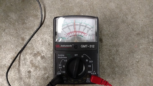

Steve D wrote:I'm beginning to think that this is just how it's supposed to be. I have all 12v circuits disconnected. I have all 120v disconnected. I have the battery disconnected.
The only things that are still hooked up are the 30a main and the 15a breaker that powers the pd4045. The voltage is still there. If I turn off the 15a that powers up the pd4045 the voltage goes away. I'll post pics of my voltage measuring technique.

jondbar628 wrote:OK, you have a differential between the trailer ground and the earth ground. THis indicates a high-resistance between the two. The ONLY real ground you have is the ground wire in your extension cord to shore power. The trailer ground "floats" otherwise. (Unless you drive a good ground rod) Does your PD4045 have an indicator light when power is applied? this COULD be a source of the problem. almost all devices connect to common (ground) to complete the circuit.
To troubleshoot, disconnect shore power. Connect one end of a wire (long enough to reach the far end of the trailer) to the ground prong of the trailer connection, and the other end to a meter lead. Set the meter on x1 or x10 on the Ohms scale. Starting at the device nearest the trailer connection, read the resistance from the common (not the ground, although it should be the same) across the meter. anything less than an ohm is inconsequential. When you get a significant increase in resistance, you've found (at least one of ) your problem(s). If you don't find ANYTHING reading abnormally, the problem is in the shore-power cord ground..............This is my second post - the first was in more detail, but got timed out.
