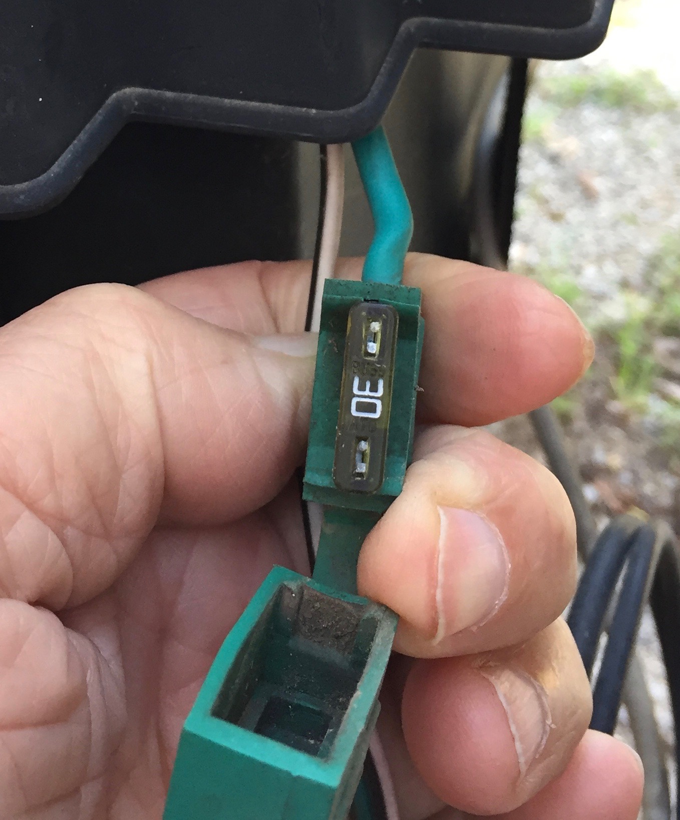

Postby swoody126 » Fri Mar 19, 2021 9:04 am
wiring for RV battery thru 7-flat prong plug on 29' travel trailer is 10ga w/ a 30 amp in line fuse from the factory
