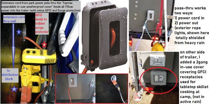

Postby working on it » Sun Apr 25, 2021 9:46 pm
* I use Taymac In-Use covers for both input power and output power cords. I use either 12gauge or 14gauge extension cords for input from park power pole, depending on length of cord needed. There's a power splitter hub, mounted on the inside galley wall, that feeds the 14gauge (extension cord) main power distribution network (thru GFCI's and a resettable surge protector...no other breakers or fuses needed). I can also use the in-use cover to feed external systems (usually a rope light), using GFCI's. The cover snaps shut to keep water out.
* It has worked so well that I chose a larger, two-gang in-use cover to water-proof four GFCI receptacles mounted on the rear outside wall, that I use for an electric skillet (my solution to open-flame cooking on windy days, or in burn-ban situations). This usually works, under cover of a canopy in light rain, but not-so-much in driving rain and high winds...I don't want to have to test the GFCI circuitry that way).
in-use covers for input and output cords, good for external GFCI receptacles too.jpg
in-use covers for input and output cords, good for external GFCI receptacles too.jpg (148.83 KiB) Viewed 1403 times
