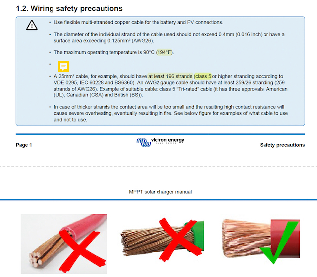

My understanding is that stranded wire should/must be used with low voltage DC current (e.g., 12v) where surface contact is critical to avoid fires. The surface contact issue is not as critical with high voltage AC current (e.g., 120v).
Also, the insulation temperature rating is critical.
For example, my Victron charger manual says:
Screenshot 2023-09-25 at 8.35.59 PM.jpg (310.9 KiB) Viewed 1105 times

featherliteCT1 wrote:My understanding is that stranded wire should/must be used with low voltage DC current (e.g., 12v) where surface contact is critical to avoid fires. The surface contact issue is not as critical with high voltage AC current (e.g., 120v).
A detail that no one ever discusses is that it's the lugs on the device that dictates the type of wire that can be used. The lugs use the wire as a heat sink to cool the device so using the wrong type of wire can cause overheating. In the US, all circuit breakers/switchgear/etc. have 75C rated lugs (including MV CBs) so you're required to use 75C rated insulation when doing wire ampacity calculations. The lugs are also rated for specific stranding of wires. The fact that Victron is requiring the fine wire isn't so much its standard practice, it's because that's what the lugs they use require. Finally, the manufacturer's installation requirements always trump general code requirements so if Victron recommends it you should use it.
Since I know that all the 120V lugs that are sold in the US are rated for both solid and stranded wire I should amend my statement that solid core wire is probably fine for 120V devices in a trailer. And what a PITA it would be to use solid wire on 12V devices, I guess I missed that in the original post.
P.S. There have been complaints regarding the push-in connectors that Victron is using on the Multiplus II inverters. I've seen a few pictures of charred lugs on the 120V output side. We wouldn't allow push-in lugs in our specs as it was generally agreed in our office that they sucked.
