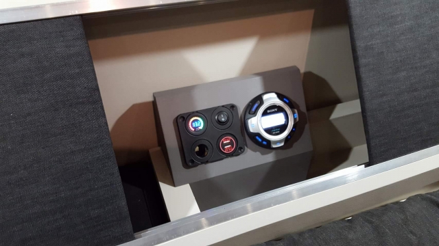

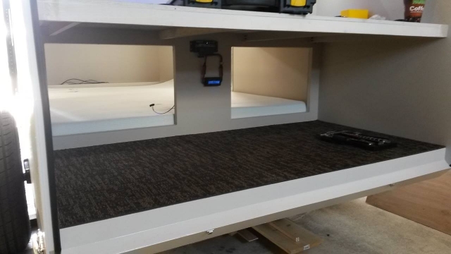

Here's my Morningstar SS-20 and my $15 power meter in the galley of the X-Cubed...
And my simple voltage meter in the headboard...
