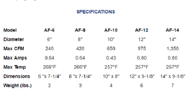

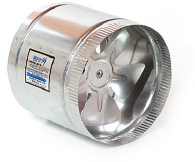

  • I didn't hack my 5k unit, and don't have to regulate intake flow and return flow thru hoses. But, I did have to enlarge my exhaust ducting exit hole, and install a high-flow axial fan inside the exhaust duct to speed the hot air outside, before it stagnated, and caused thermal shutdown. Several of you are trying to get the right combination of hose sizes and if or not to install a helper fan (and what kind of fan, and where to put it). Shadow Catcher has the additional problem of also running heated air(from his heater) thru the same hoses as the cooled air.
  • I think one of the axial fans made by Aero-Flo Industries http://www.aero-flo.com/axialfans/ can be used even with heated air; mine is inside the exhaust duct from my A/C unit, and fares just fine. I bought this brand because they claim they're good up to 266 degrees F (more than my exhaust temperature, and probably more than Shadow Catcher' s heater).
    Aero-Flo axial fans chart.PNG (48.26 KiB) Viewed 19579 times
  • I used the 6" model, with the lowest air flow in cfm, but it performed great, did what I needed, and I didn't have to upsize. I'm sure it would be worth installing in one of the hacked hoses, even if it was in a larger section of hose attached to a smaller one. After all, it's rated at 240 cfm, versus a Frigidaire's 120 cfm output. It could be installed in both hoses as well, since the current draw is so small. It might be worth it for you guys to try, besides, they're made in the USA.

My question on thise fans would be at what static pressure are they producing that airflow. A 5" flex duct only carries about 50 cfm at .5 in/wc if the static rating for those fans is near that then you will potentially shorten the life of the fan considerably. I do residental and commercial hvac for anliving and a 5000 btu unit (.417 ton unit) by industry norms needs about 167 cfm. Am i missing something that is radically different with using this type of unit as I am planning a similar design for my camper.
