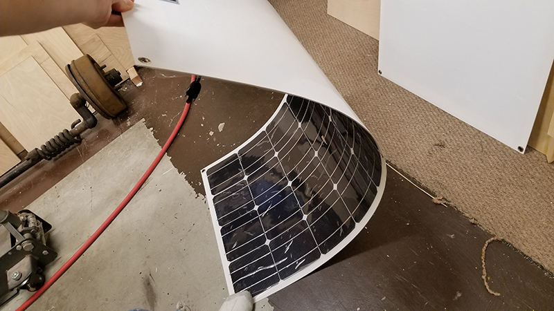

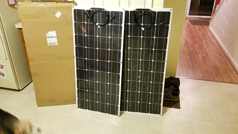

For anyone interested in some fairly inexpensive panels, I just picked up two 120W flexible panels from ebay for my Scotty project. They've come down in price, to $119 with free shipping. Mine got here yesterday, and while the packaging wasnt the greatest, the panels look to be fairly good quality. I've bought the Solar Cynergy panels from SolarBLVD before, and have been happy with them. $1/watt for smaller panels is hard to beat!
https://www.ebay.com/itm/120-Watt-120W- ... 1754059260
The panels are shipped with a thin plastic protective film on the surface, which is the discoloration you see in the pictures. It peels right off and leaves a super smooth surface. These are monocrystalline cells.
