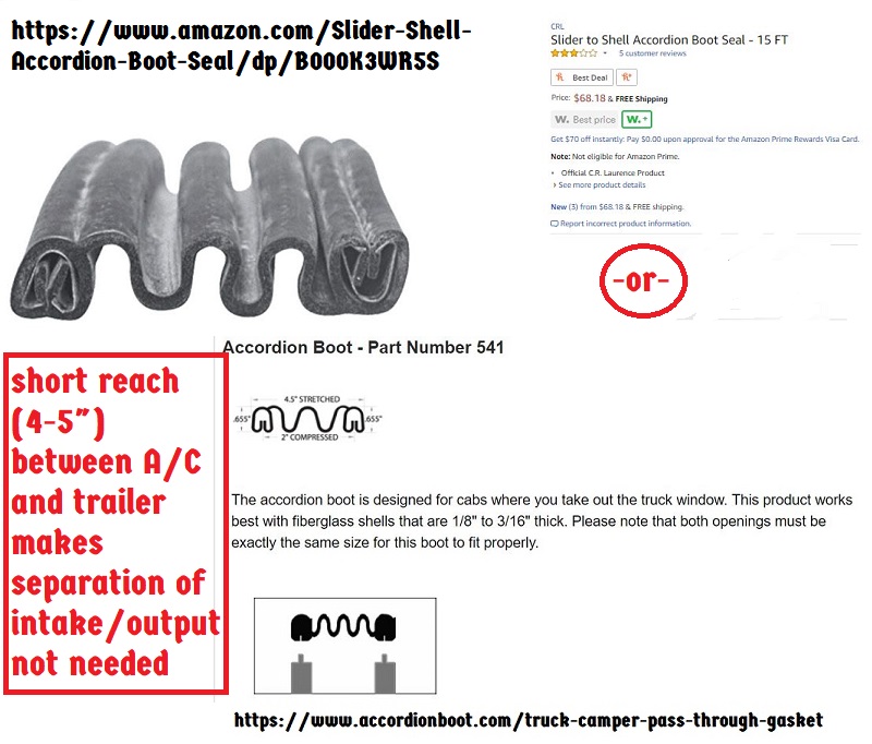

  • As I've stated before, I installed my 5k unit totally inside my TTT, not exposed to the elements, or subject to creepy-crawlies, or any debris found outside the trailer. It is firmly mounted inside a cut-out in the 3/4" plywood bulkhead, insulated and sealed-in with OSI Quad flexible sealant, taped over with multiple plies of foil tape. Everything is firmly supported with extra oak framework and struts, so there is no window (or woodwork) shaking going on. Though I added a high flow axial fan into the exhaust ducting, the entire exhaust system has fiberglass insulation covered with more layers of foil tape, so no vibratory sounds are transmitted from it. Ever been in a new motel/hotel room with a thru-wall A/C unit installed? It emits a (to me) quite pleasant hum while operating... as does my 5k "window" unit. Besides, I require a source of white noise to be able to sleep (due to tinnitus), and the A/C sounds also bring back memories of my early years, when all my relatives' homes had "window" units.
  • Concerning regulating the 4 types of air flow using A/C (output air, intake air, chassis ventilation air, and exhaust), the various areas are handled in these ways. The first two are inside my cabin, and require no separation, since the output air is directed upwards along the ceiling, then it returns via the floor area (reverse-convection, aided by the shape of my trailer's front sloped wall).There has been no icing-up, or interior condensation, when using the A/C, due to high flow rates (I use an opened vent w/computer case fan, and a small air circulator fan with up to 350 cfm). The chassis cooling is handled by ambient air (in the galley, supplied by external vent) drawn thru it by a quiet 120vac computer case fan, and the exhaust is totally sealed-off in a highly insulated 6" diameter flex hose, straightened out to extract the exhaust without much interference from the internal hose ribbing (aided by the 266 cfm axial fan inside), from a rectangular, right-angle "vent register boot" (modified to transition smoothly to the flex duct). I had problems while trying to make it flow out a sidewall-mounted, rainproof vent, but ended up just by using the vent as a cover, lifting up and away for full exhaust flow.
  • If I ever "hacked" a 5k window unit, I would use a large rectangular shroud covering the entire front of the unit (with a divider separating the intake from exhaust), connected to the trailer via a short rubber accordion boot/truck camper pass-thru gasket. The A/C unit would sit above ground level on a side-table secured as usual, so it wouldn't fall, and the exhaust and chassis cooling would be left to nature, not having to flow thru too small flex hoses. Just an easier solution to hoses. I wish I hadn't done my complicated exhaust duct, but instead, just use a short accordion boot to vent out mu closed hatch...I've thought about this easy-out method for awhile, now.
    accordion boot seal.jpg (153.03 KiB) Viewed 13507 times

working on it wrote:If I ever "hacked" a 5k window unit, I would use a large rectangular shroud covering the entire front of the unit (with a divider separating the intake from exhaust), connected to the trailer via a short rubber accordion boot/truck camper pass-thru gasket. The A/C unit would sit above ground level on a side-table secured as usual, so it wouldn't fall, and the exhaust and chassis cooling would be left to nature, not having to flow thru too small flex hoses. Just an easier solution to hoses. I wish I hadn't done my complicated exhaust duct, but instead, just use a short accordion boot to vent out mu closed hatch...I've thought about this easy-out method for awhile, now.[*]
[/list]
Thanks. Here's another idea for your accordion boot seal.
The evaporator squirrel cage moves the cooled air upward, and then forces it around a tight 90 degree internal elbow to the front grill. In order to allow even more cfm to be moved, why not blank off the internal elbow, and cut a rectangular hole in the top of the window shaker? This would allow more cfm because we have omitted a inefficient short sweet elbow .. Then use your accordion boot rectangular "duct" to connect the new cold air supply hole on top, through the trailer floor to a plenum inside the trailer? Or a rectangle to round "boot" if you dont have enough room under the trailer.
Regular flexible Return duct is fine. Its the supply air that needs a easy slippery path, and with the above design, if you looked down the trailer supply plenum you would see the squirrel cage blower. Cant get much better than that and not have to worry about any other support booster fans.
Window shakers were never designed to be mounted inside anything other than a window, and will run hotter with shorter lifespan if not supplied enough fresh condenser air. From what I remember, the beauty of a window shaker design is that it uses one motor to move evaporator air and condenser air.
