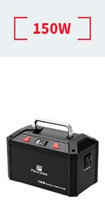

Will be camping down south this winter and dry camping part of the time. My resmed cpap runs on .7 to 1.2 amps . Will use the machine for 6 hours a night. I would like to use a fantastic fan at the same time and 12 volt reading lights for 3 hours or so. Will have to do a solar setup and dont have a clue about the size battery or the size of the solar panel? Any help or suggestions will be appreciated. Does anyone have any experience with so called all in solar generators. It was reccomended to me by the sleep center

I too use a CPAP.
Your fan will burn 1-amp/hour. And of course, your iron lung will eat about 6 amps. Thus you'll be using about 9 amps/night.
A Group 24 AGM battery has about 45 useable amps when new. So without charging, you could run 3-4 nights.
Here's a 160 watt folder: https://www.solarblvd.com/products/solar-cynergy-160-watt-foldable-12-volt-solar-panel-2/. They say 7 amps/hour. That and some sunshine is all you'd need for stays longer than 3-4 nights. If you are traveling ––and charging while towing–– you wouldn't need solar.
I'm failing to see a challenge here. :thumbsup:

Get an AH counter like WattsUp (low ampacity but cheap) and actually measure your loads' total in **AH** per 24 hours.
Amps per any-time-measure is not meaningful, only as an instantaneous measure of flow rate, not a fixed quantity.
The best battery value by far is Duracell (actually Deka/East Penn) FLA deep cycle golf cart batteries, 2x6V, around $200 per 200+AH pair from BatteriesPlus or Sam's Club. Deka labeled same batts also sold at Lowes.
Even the very large powerpacks are small AH and **very** expensive. They are not "generators", marketing deception there.
The 200AH should be plenty, and spending less than $200 on storage is unlikely to get you true deep cycling quality, needed for longevity.
If you keep using your AH counter, you can keep your usage below your daily input from your panel.
100W may be enough, but I would start off with 200W, want to be ready for worst-case weather conditions.
Obviously as your usage grows, be ready to add more panels, but that 200+AH bank should be OK storage for up to 400W panels.
