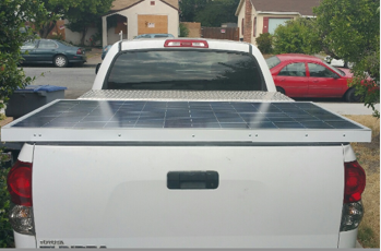

Postby OverTheTopCargoTrailer » Sun Jul 19, 2015 6:39 pm
Charging while parked
Screen shot 2015-07-19 at 4.29.13 PM copy.png (135.05 KiB) Viewed 14804 times
