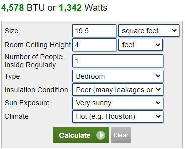

I found an AC calculator https://www.calculator.net/btu-calculator.html which let me know with the insulation I have 1.5 Inch EPS and six surfaces I needed 5000 BTU It is however based on having a return as Social Tom pointed out. As I indicated you can try it and see what happens, at worst it will not do the job you want and you can add the return.

Shadow Catcher wrote:I found an AC calculator https://www.calculator.net/btu-calculator.html which let me know with the insulation I have 1.5 Inch EPS and six surfaces I needed 5000 BTU....
I had used other calculators prior to using this one, and arrived at the same conclusion...that an uninsulated plywood 4x8, as small as it is, with 77.5 cubic feet of space to cool (75 inches inside length x 46.5 inches wide x 48 inches tall x .80 reduction factor for volume of air lost by cutting a 45 degree angle off the roof), needs a lot of cooling since it is primarily used from late April-October, in Texas weather.
It has been proven very effective over many years. Mine's a LG LW5012j, 5k unit, not hacked, but permanently installed in the rear bulkhead. Less than 25% of the trips I've been on didn't require A/C, so a permanent mounting was proven to be the best way to use mine.
