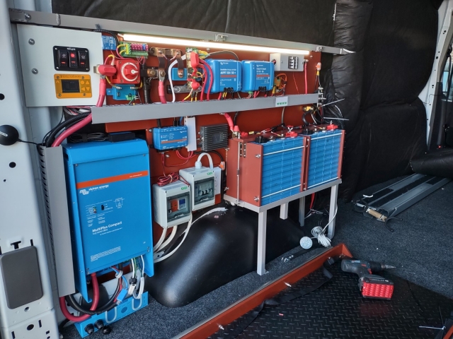

This is an option too:
Unlike AGM batteries you can mix different age LiFePO4 batteries. If you decide you want more capacity in a year or so you can add another 40 a-hr battery in parallel to the one you have now.
P.S. You might be able to tell from the blue that I really like Victron: ;)
