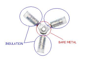

kayakrguy wrote:Dale,
Why put the shrink over the Y ? I would simply heat shrink each of the individual joints...just like I would with a regular two wire connection. I see no need to shrink on the center connector....
Jim
GOOD...leave center exposed, when HOT LEAD (12 volt) shorts to ground its fun to watch fuses pop and if no fuses wires melt....
Any exposed current carrying conductor is a possible source for a problem... Key word here is "exposed".....

Postby kayakrguy » Wed Nov 08, 2006 7:11 pm
Dale,
If I read the Ancor Y description correctly , the center of the y splitter is insulated...not bare or 'open'. I realize that many folks prefer solder for all wire joins and that's fine for them. But as to using shrink wrap, I think that will work just as well with a properly crimped joint as it would with a solder joint. My concern with solder is that it is usually more brittle than the stranded wire it joins.

Postby Sonetpro » Wed Nov 08, 2006 7:38 pm
Jim,
I also have 25 Years telecom experience. I also have had alot of trailers. And to top it I have a Jeep. So I know what electrical problems are. I would not use those. They are a problem waiting to happen. All my connections are soldered and shrink tube. Exposed copper corrodes and so does the connections.
From what I see in the pic , only the ends are sleeved.

Postby Dale M. » Wed Nov 08, 2006 10:32 pm
Just curious...are you an ex-telephone guy?
Jim
You need to hike on down to local Kragens or O'Rilley or AutoZone and take a look at these connectors......
Yes .... 38years... Western Electric Inc. and AT&T Network Systems Inc. and late of Lucent Technologies.
